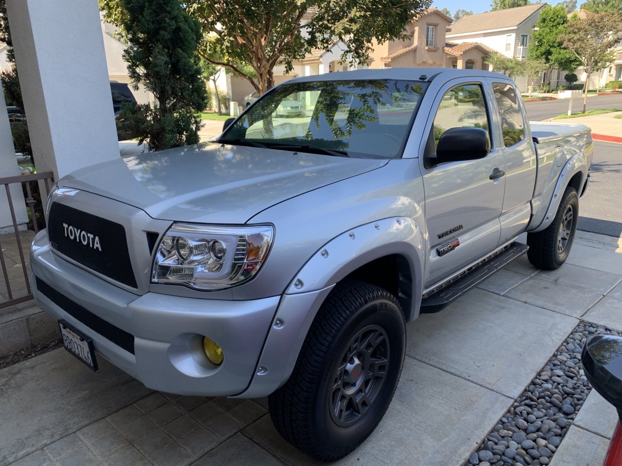

    I have a set of Bushwacker flares painted to match my 2006 Access cab, see below. The Bushwacker flares I got are smooth so the body shop I used had no problem doing them gloss to match the body. I think the factory flares if painted have a matte finish.
    One note, I had other body work done at the same time so I had most of the body repainted the same time as the Bushwacker flares. The body shop said if I had only painted the flares it would not have matched the body color that well due to fade on the body paint. Since yours is a 2012 it may have some fade, so doing a matte finish on the flares may be the best way to not have a noticeable difference between the body and the flares if the flares are gloss. They should be able to use a matte or satin clearcoat versus gloss. The shop I used said it's not always easy to get an exact match on a plastic surface as compared to metal. I think they used a color primer on the flares to get a good match to the fenders.
