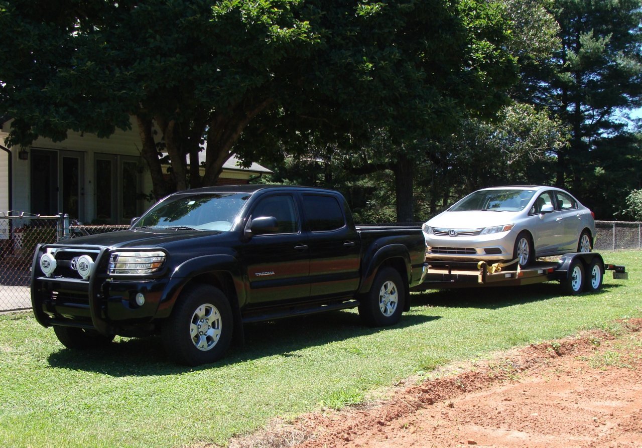

    I ended up buying a Tekonsha Primus IQ, along with the PnP double connector cord. Took about 15 minutes to install. Sweet.
    Gonna give the controller a workout this weekend, towing a car on the flatbed 160 miles:DSC00669.jpg
    The car is about 2800 lb. the trailer is 1800.
