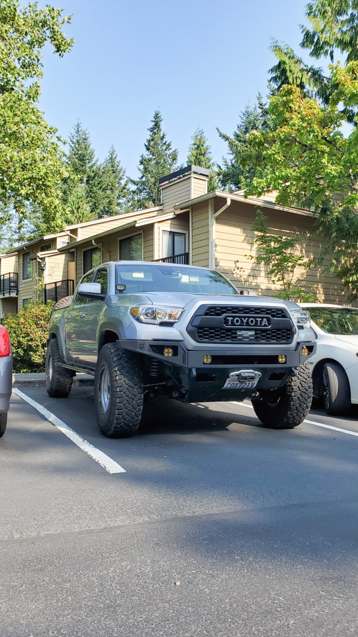

    rimfire7
    rimfire7 [OP] I'm here for the tacos
    Dec 13, 2020
    #349474
    794
    beth
    2021 army green taco
    Toytec lift, old man emu springs, Victory 4x4 front bumper and skids, light bar
    I noticed at the dunes I tend to bounce pretty hard - not trying to but you now it just goes that way at the dunes. Was wondering if upgraded bumpstops on top of upgraded suspension would be a good idea. Thanks.

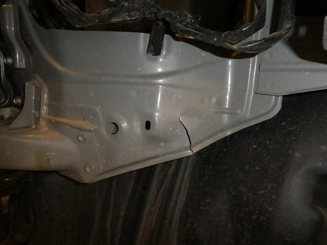

    Look i smash forest service roads all day long and my core support is now tearing so I mean better bump stops would def help if you hammer the truck

    Vegasstunts
    Vegasstunts Well-Known Member
    Dec 27, 2019
    #314287
    751
    16 TRD sport
    All of them.
    Mine is shredded up there. I have atleast 10 huge cracks on my driver side support. You can always tell who runs hard and who doesn't by this.
