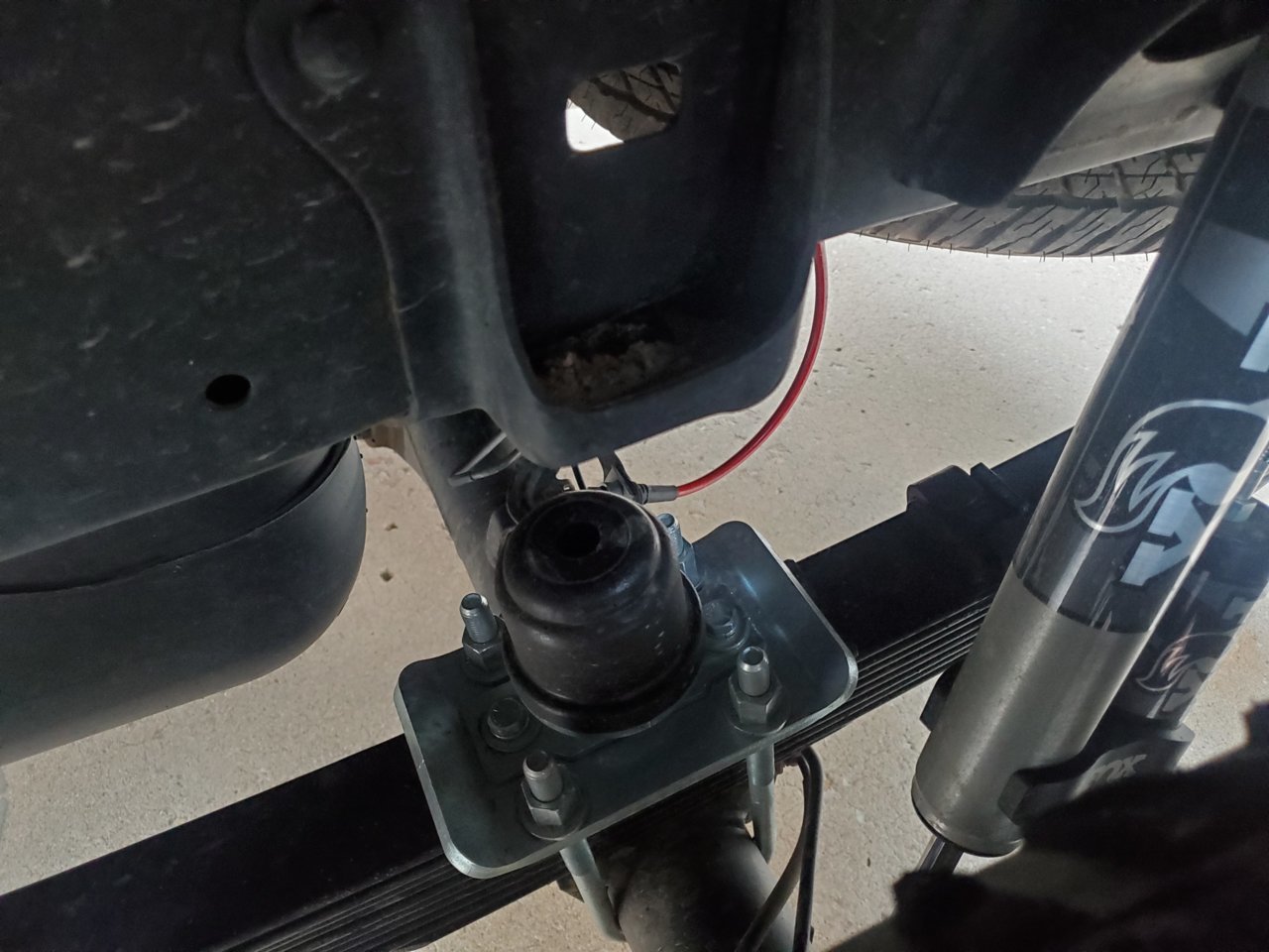

    Did your plates kind of bend when you torqued everything down as well??
