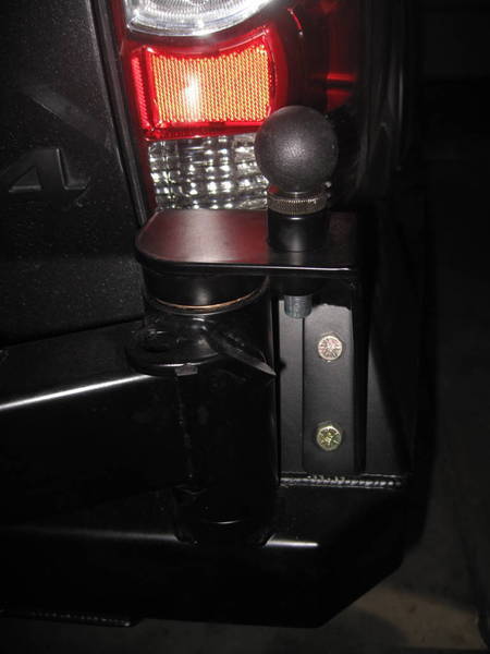

    Yes the swing out is removable. The bushings that are in the swing out are very tight on the spindle and I found it very hard to get the swing out on, so I am assuming it will be a little difficult to remove it when need be.
    To remove the swing away there are a few easy steps. There is a top plate that sits on top of the spindle, it is bolted to the bumper (this helps prevents theft of your swing out, but is easily removed if you have the tools to do it) and has a set screw in it. Back out the set screw, remove the 2 bolts holding the top plate on the spindle, take the top plate off and then you are ready to lift the swing out up and off of the spindle
    Top plate that goes on top of spindle and is bolted to the bumper.
    Set screw on top plate

  7. Feb 28, 2013 at 10:31 AM
    agv1700
    agv1700 Well-Known Member
    Dec 11, 2010
    #47516
    131
    Angel
    Black DCSB 4wd
    Outstanding... Thx for the reply!
