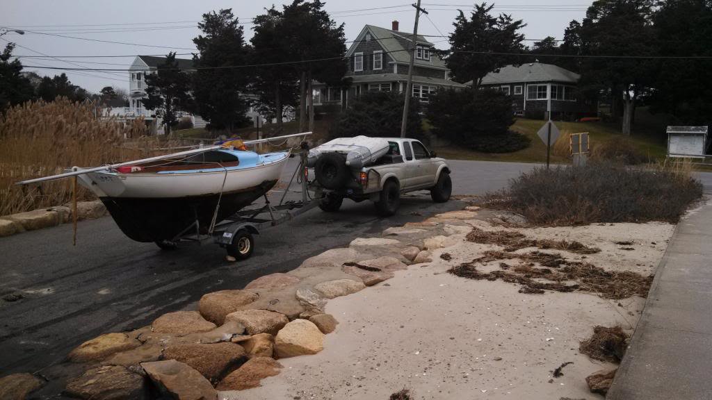

    As far as towing a 16 foot whaler you will be fine. I tow a 15.5 foot full keel sailboat that probably weights 300-400# more than a whaler, I have towed it on a couple long trips with no problems or complaints. The brakes are a bit underpowered but that has a lot to do with my larger tires and the fact that my drum brakes are usually caked in mud and don't work.

    Capetaco, thats a great looking boat. It looks like a Cape Dory, but the rudder looks different? How does your Tacoma tow on the hills?

    It is similar to a dory but its a bullseye based off of a hershoff design. Carl alberg designed the dory and my father and I actually co-own an alberg-37 which is basically bigger dory.
