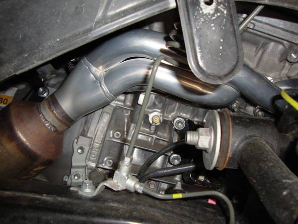

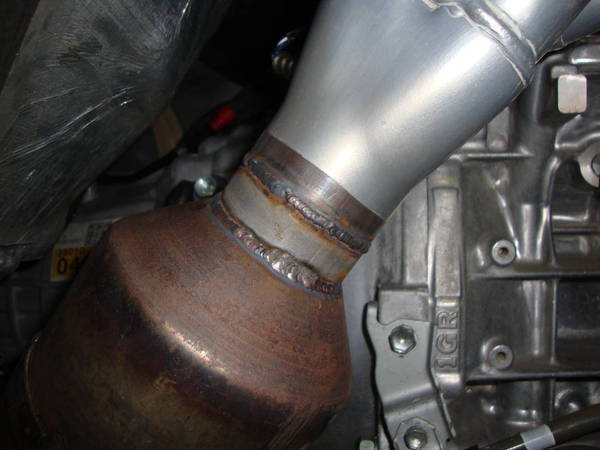

    For a quick and easy change in sound and performance, go with a cat back exhaust system. It took me about 15 minutes to go from stock exhaust to performance exhaust. I have a Banks Monster , stainless exhaust, and everyone that heres it says it sounds great. The headers are a little more complicated. The exhaust manifolds on the 4.0L have the main Cats attached to them. There are two options there, either get long tube headers, which will delete those cats, but you will need o2 simulators to keep from having a constant check engine light, or get short tube headers, which you will need to have the manifolds cut from the cats and welded to the headers. I have the short tube JBA headers here
    The shop I took them to did an amazing job. People drive over hundreds of miles to have the guy work on their rides. Look up DeCordre in Spring City,PA.

    No joke! Those look factory! Nice!
