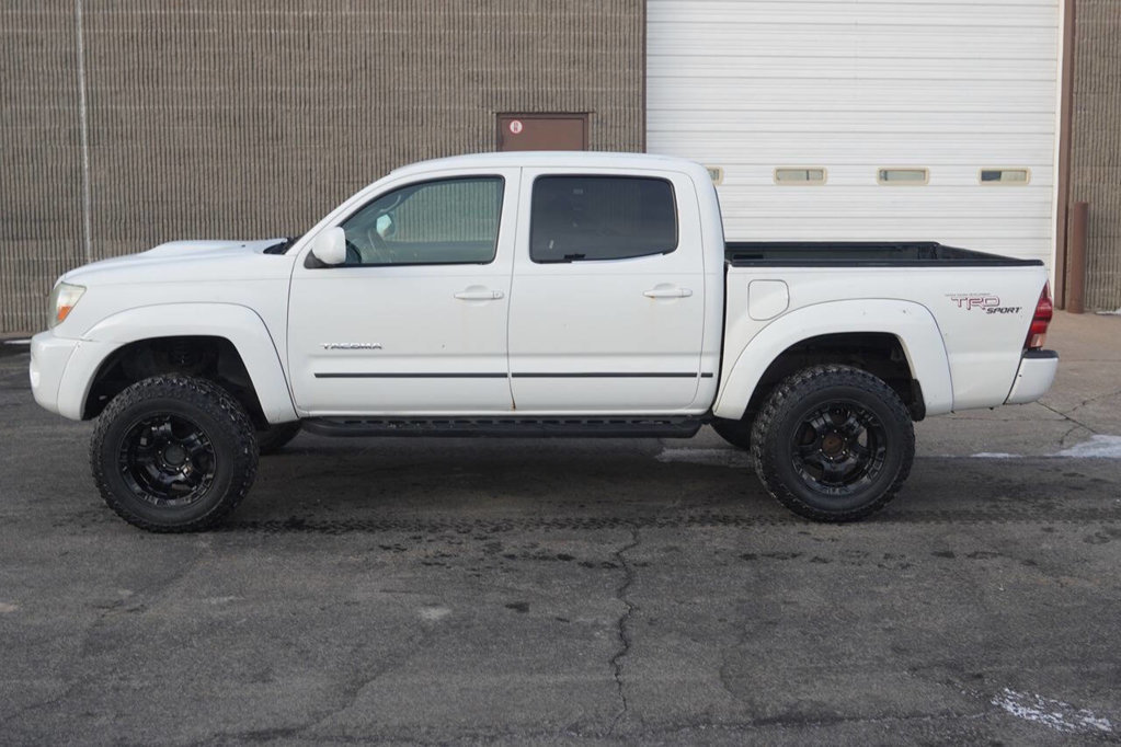

    Hello! New to the forums, and very likely a soon-to-be owner of an 05 Taco TRD Sport!
    I wanted to pick your guys brains a bit with a couple problems I saw on a truck I may be purchasing in the immediate future.
    When taking it on a test drive I noticed that the wheels have a wobble to them, and that the steering wheel needs to be turned about 45 degrees counter-clockwise to remain straight.
    The truck is lifted a couple inches and has beefier tires on it (I could call and get the specifics, it's not listed on their ad and I'm not in possession of it yet to confirm myself.
    Now, don't just think the resolution is the first thing that comes to mind, an alignment.
    I checked the carfax on it and it's had one done pretty recently. The fella selling it is an auto shop owner whos said he did one himself, that "it's just how the truck is".
    First-off, I think that statement in itself is...questionable. that's not just "how it is", maybe it's how it is RIGHT NOW..I digress.
    My question for you fine people, what are the common things that could cause this?
    I've watched a lot of videos and scoured the forums for some answers, and found that the camber bolt could need to be replaced, that there could be an issue with a part of the steering assembly, and user "Dirty Pool" suggested a few years back to:
    "In a nutshell, in this order.
    Disconnect the steering column/shaft from the steering rack.
    Center the spiral cable (under the steering wheel).
    Center the steering rack in its range of travel.
    Reconnect the column/shaft, keeping it all centered.
    Install steering wheel straight.
    Do alignment, correctly.
    If steering wheel is slightly off at this point it can be centered by turning both tie rods equal amounts in the same direction. One direction or the other to bring the steering wheel to center."
    What are other things I should check, or do, to correct this issue?

    Frame for rust. Red flag on the” just the way it is” attitude from the guy that did the wheel alignment.

    Welcome to Tacoma World. If I were buying a vehicle from someone who presumably owns an auto shop and they can't even do an alignment or tells me "that's just how it is", I would laugh in their dumb face and run away as fast as possible. HUGE red flags and likely a sign they don't care about maintenance even if they tell you it was done.

    Big pass on that truck. The seller is an auto shop owner and he can’t fix that? Something major screwed up and the seller is a liar. The lift was likely poorly done. Find another truck.
