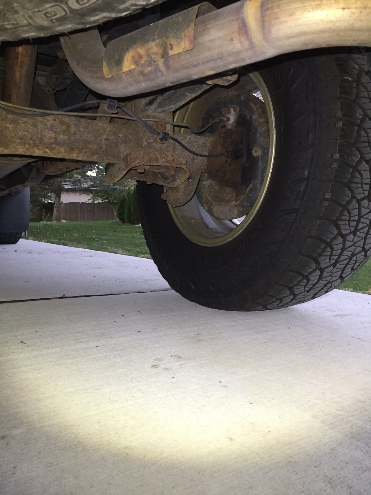

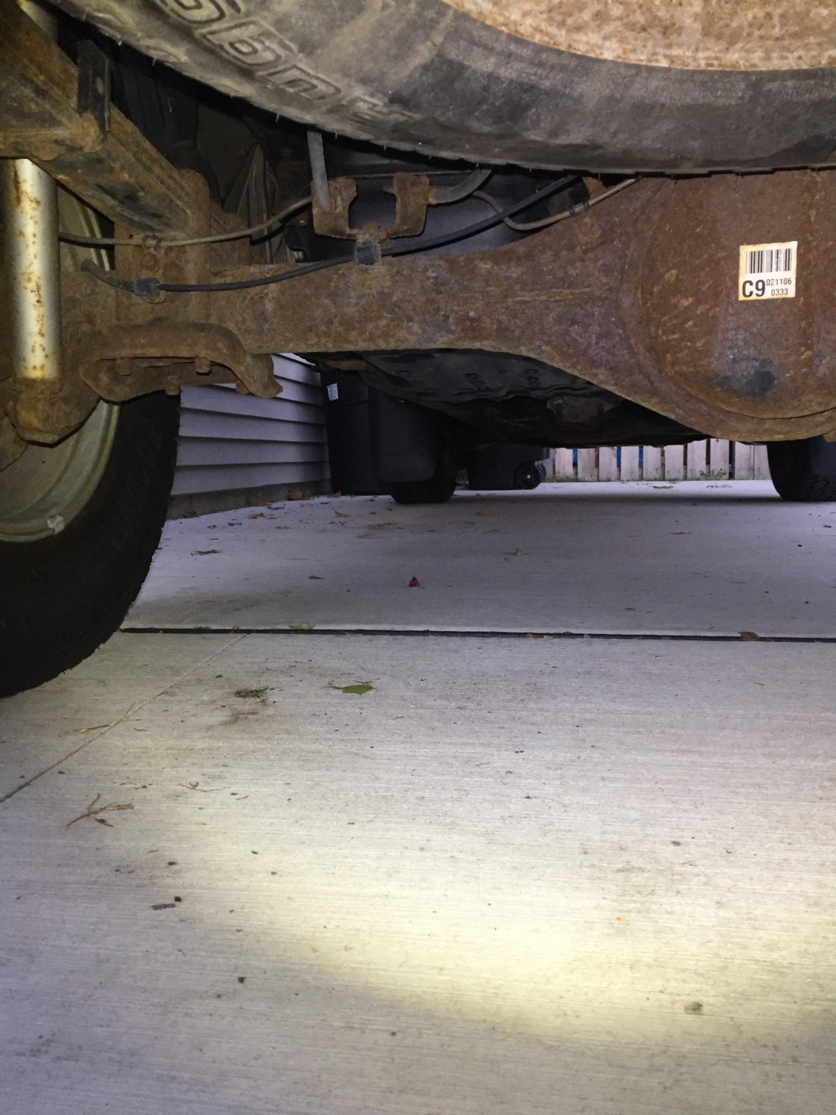

    Thanks yeah, We're battling a C1239 "Metal on wheel speed sensor" and a malfunctioning ABS module. No other problems in the axles. We're not sure if the E-Locker will engage but.....4 Hi works fine thou....
    the frame has already been replaced, and We got new shocks. The emergency brakes had to be cut due to the cables.
    here is a picture of the rear axle.
