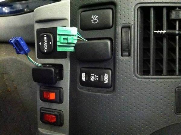

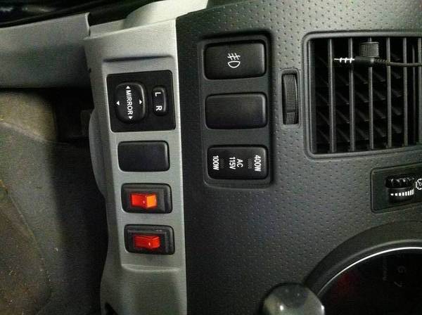

    Could anyone tell me what the plugins behind my blank switch covers go too. I think there are 2 or 3 of them that are not plugged into anything.. Just noticed them while i was mounting some rocker switches......Its a 2006

    They're for the TRD offroad options. One is a locker, one is a power inverter and one is a (correct me if i'm wrong TRD owners) downhill assist.

    Or possibly factory fogs?

    Here's the switches on my 07...

    I ASSUME ur a TRD sport due to the skewp and color matched mirrors
    X2
    with wire colors
    he should have the inverter if he is a TRD sport (which I suspect)........
    he has a TRD sport I think and should have fogs already as indicated on ANY of the 2nd gen TRD packages...........as well as his sig pic.

    Yes it is a sport.....
    this should help..........Im guessing those are for the offroad package..??

    there also one for a clutch start cancel for the manual trans trucks
