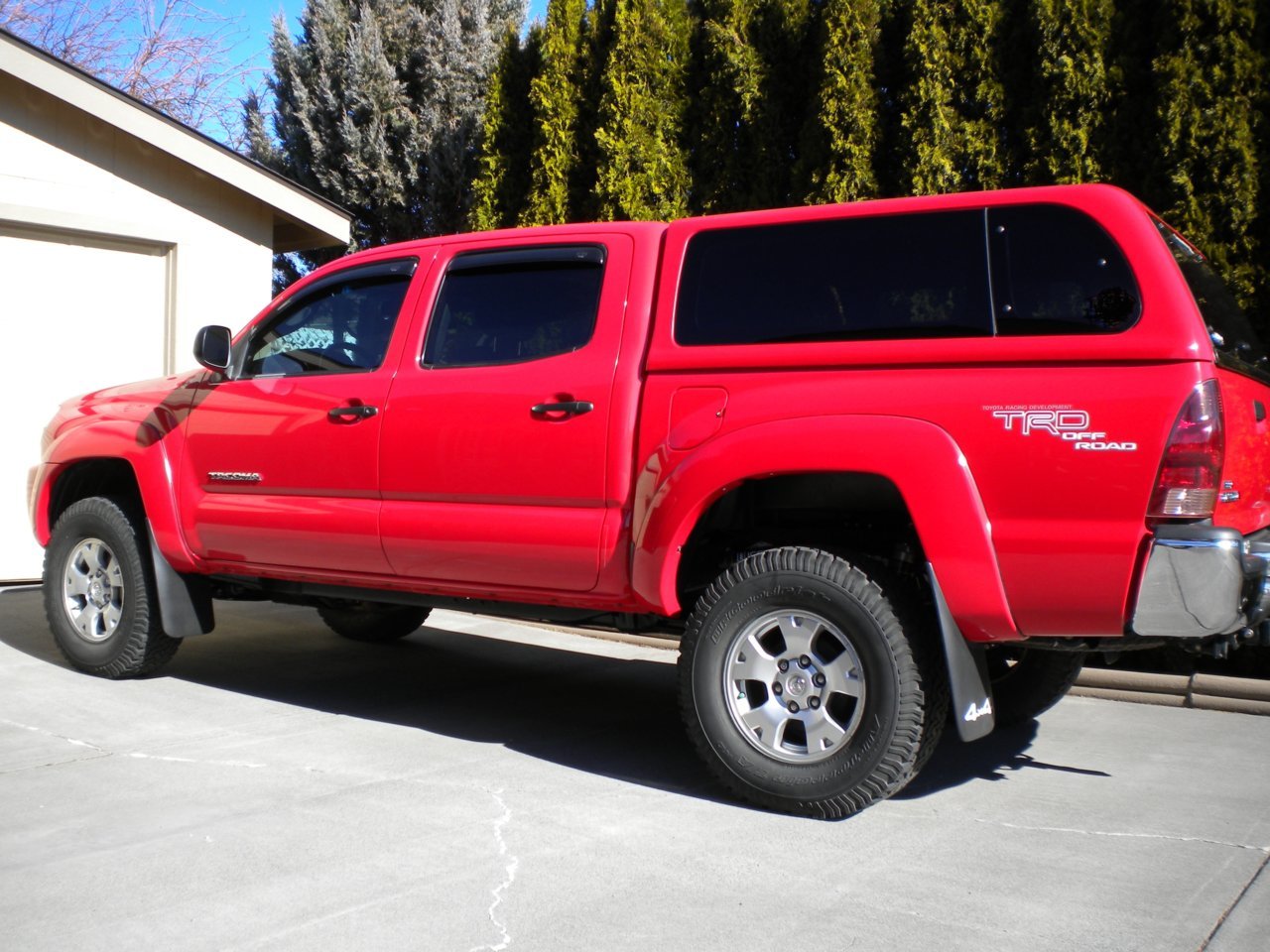

    I went with option 2 (Icon stage 8) and with the weight of a snug top canopy, around 100lbs of gear/spare tire/bedmat and 200 lbs of sand bags the hub to fender is 24" on my 2nd gen. With the front coil overs at the factory 2" setting the hub to fender is 22".... got a 2" rake going. Hoping when it gets broke in and the sandbags removed it gets to a 1.75" rake which is around what the truck had when new. If the leafs ever sag in the future i always have option 3. On a side note... no vibrations or shims needed.

    That is good to know. So essentially you are getting more lift on option 2 than advertised? Do you have the sand bags in there to try to speed up the sag?

    Right now (had it installed a few months ago) it's a bit more but thinking it will drop a 1/2" once it settles out. Even if it doesn't drop I'm happy with 2" rake (for towing the boat and I like the way it looks.) The sandbags were for the ice/snow but i'll leave it in for a while to get things settled... the truck actually rides great with the extra weight.
