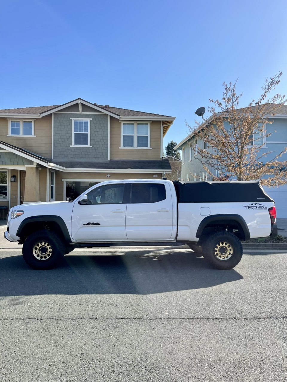

    pic for reference I do have a trail limo

    I’m 2” up front and I’ve had the leaf pack on for a month went off-roading full camp gear next day after install. No sag at all so far. Super stoked on it. When loaded this pack barley moved :)

    Just to clarify, you mentioned 2" of rake before and 2" up front so did you end up getting around 4" of lift in the rear on option 2?

    No just 2.25” from rear leaf pack front is set at about 2” of lift also
