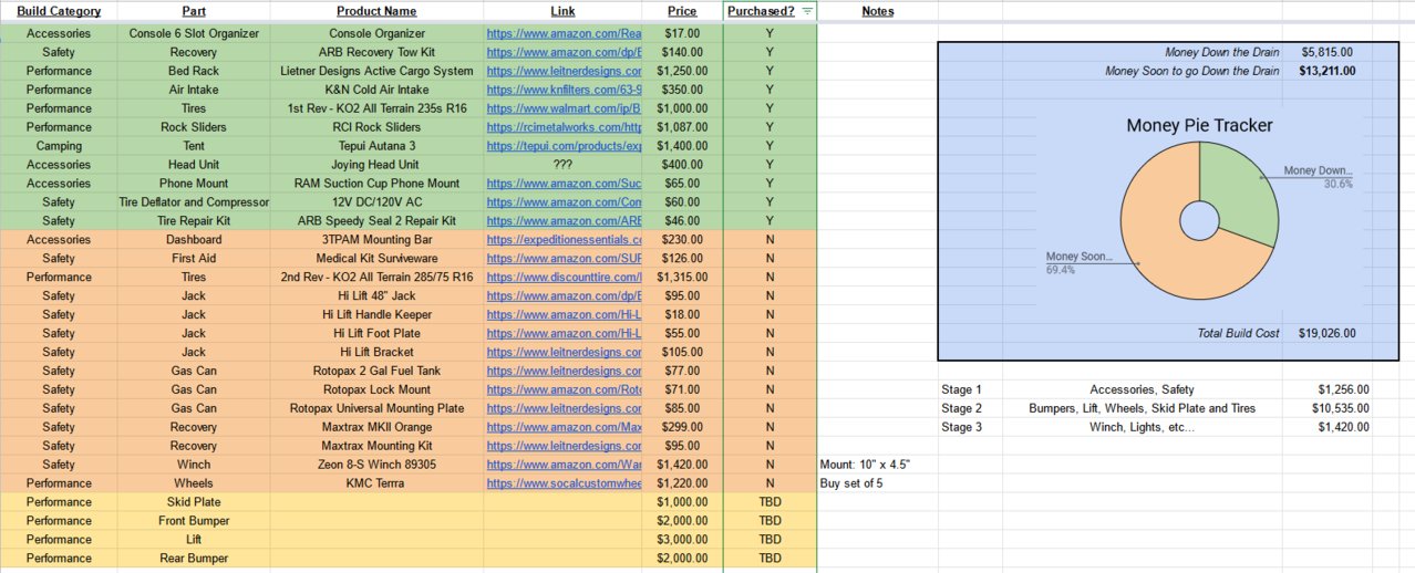

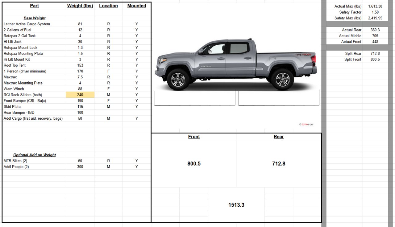

    Hi All - I've been hunting around for a lift kit for my 2019 TRD Offroad Tacoma and trying to determine what leaf spring kit (light, medium, heavy duty) to choose. I've listed out just about all items I plan on purchasing and documented their weight below:upload_2022-3-20_11-3-7.jpg
    If I'm understanding this correctly, I would require the heavy duty kits which generally run at 600lbs+. Can someone help explain if I'm understanding the situation correctly?

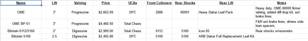

    In terms of which lift kits I'm looking it, I've narrowed it down to the OME and Bilstein "standard" and "top shelf" kits (see below).
    I'll be doing some moderate off-roading in Sedona like broken arrow and some other similar places, but nothing insane. What's your recommendation for a full suspension lift kit?
