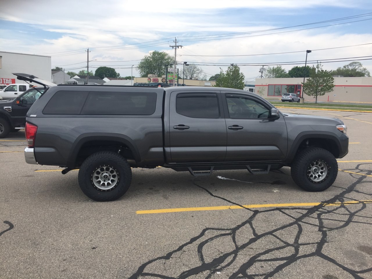

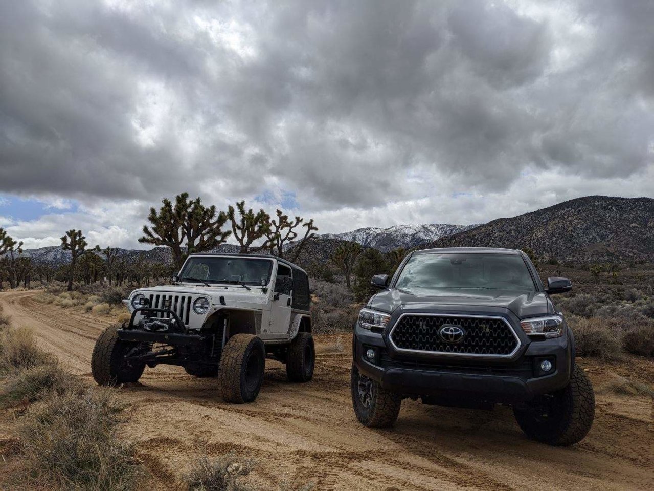

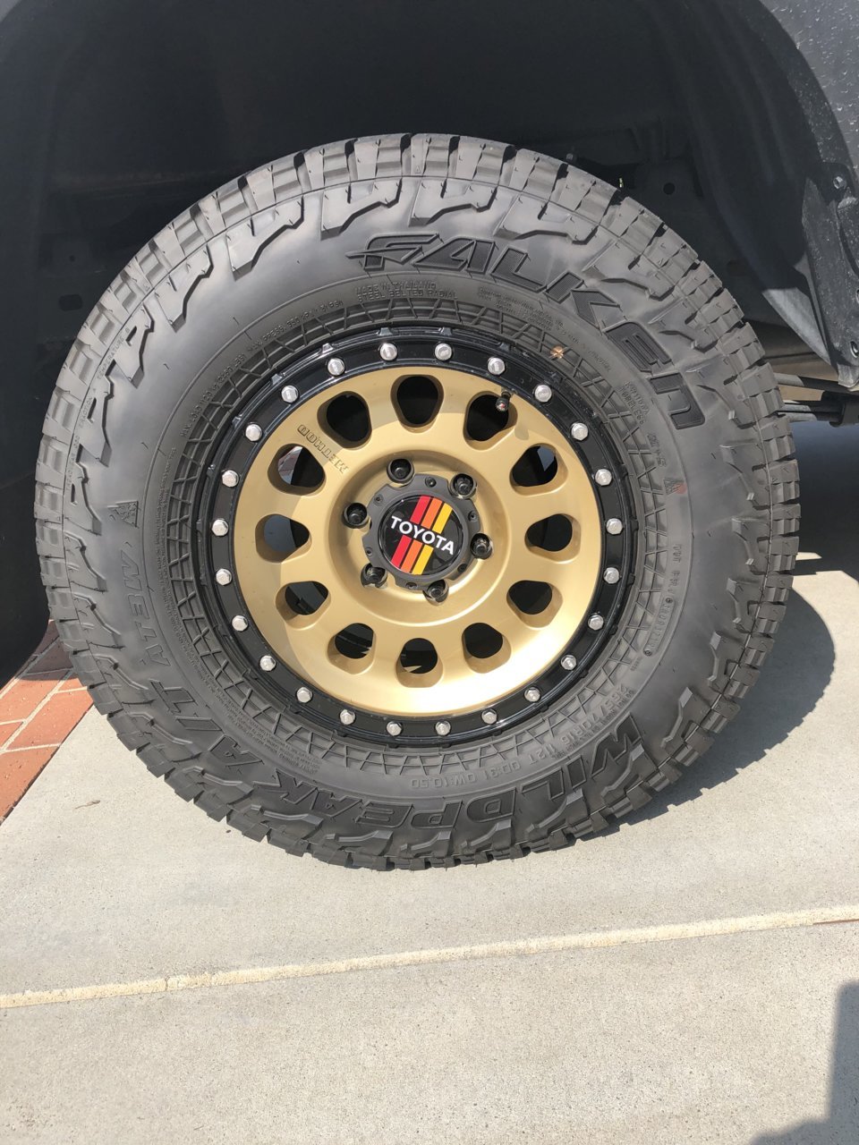

    Go with SLs. No difference visually and the ride is great. I got 35K out of mine before changing to a different tire (E rated STT). I’m back on Falkens in a 275/70R17 C-load.
    STAY AWAY FROM E-rated TIRES!!!! They are way too stiff unless you are super heavy.
    52547ABB-9BF1-4A69-A885-F5362F2B7DA9.jpg BE21E6CA-CCCB-45BD-84B4-1B18BE6F1990.jpg 05AFBFE4-41B0-416A-A6F1-0BA026D7CD8E.jpg

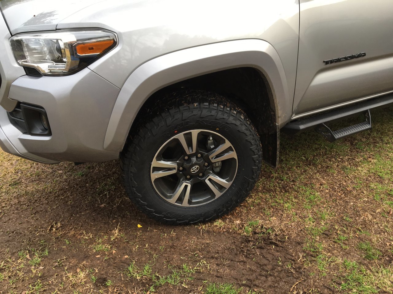

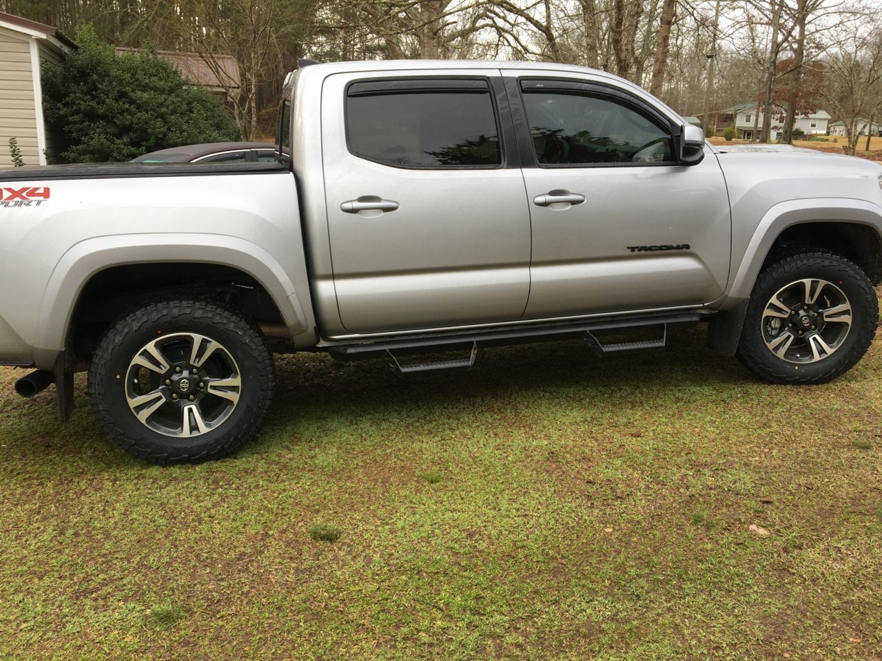

    AE89A0D1-5445-4A2D-B36A-BDFC957DCECE.jpg DFFE10C2-90A3-4671-B779-45201638C4EA.jpg I’m running them on my Sport with no problems at all. P265/65-17.
    About 5000 miles and like them a lot on highway and off-road.

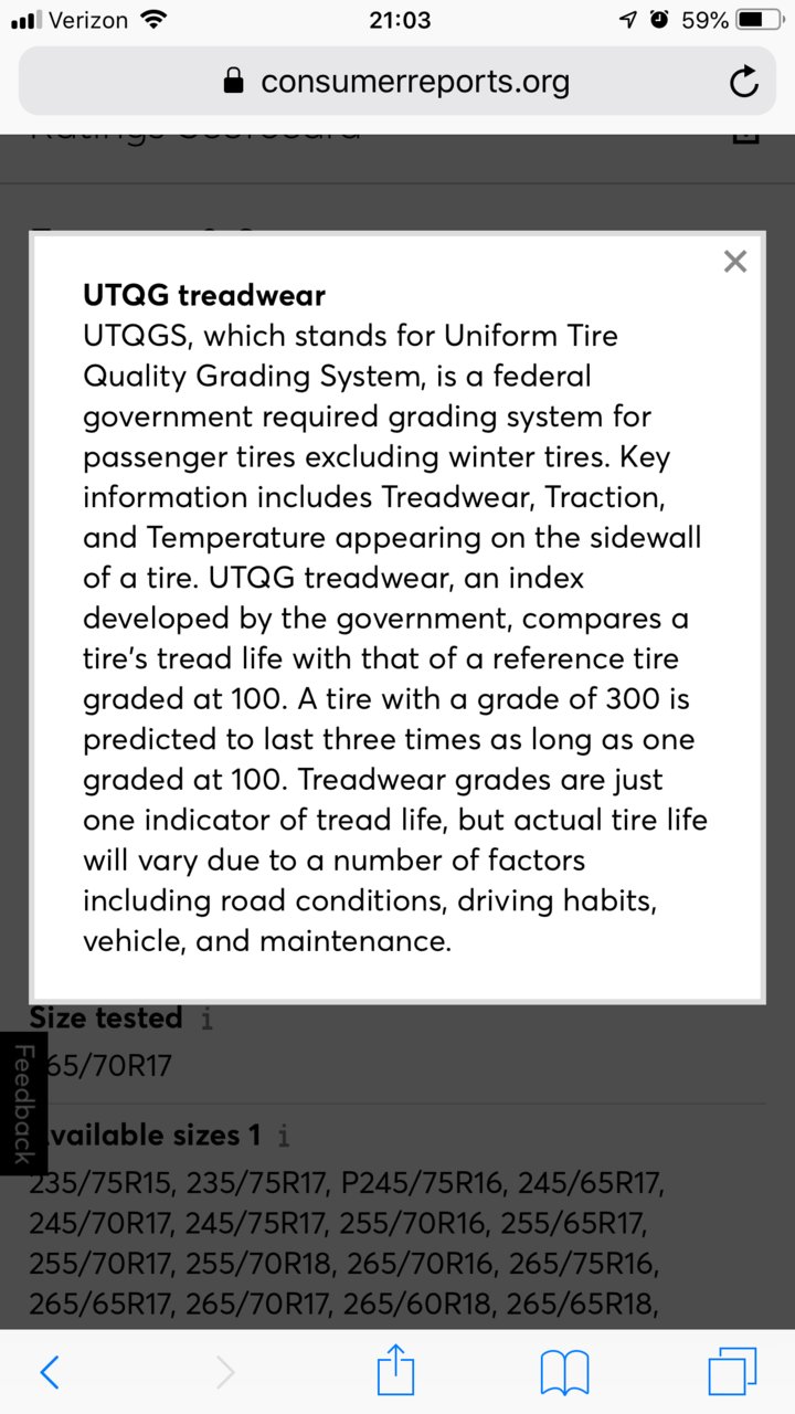

    Because it says it right ON THE TIRE RATING! DuraTracs are only rated at a 500 treadware. The Falken AT3’s are rated at 600. On a comparative scale of tire quality between treadlife, wear, and other factors BASED ON UNBIASED DATA, the DuraTracs don’t stack up that well. Don’t be ignorant get educated...:annoyed:
    https://www.goodyear.com/en-US/tires/wrangler-duratrac/sizes-specs
    https://www.consumerreports.org/pro...k-tire/falken-wildpeak-a-t3w-388225/overview/
