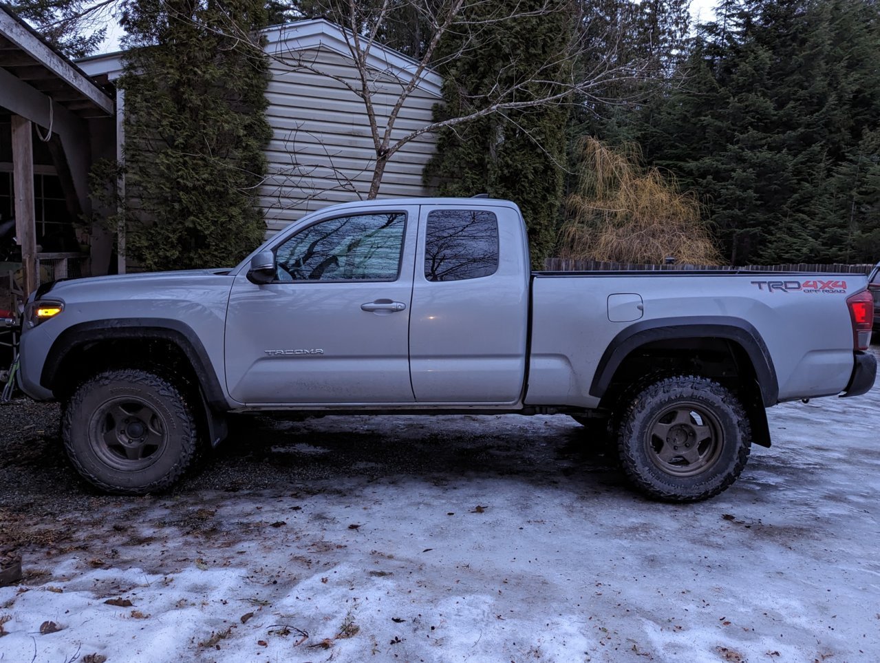

    I just put my mine on without the extra leaf(stage 1). I think the ride is great, I prefer it over stock, handles bigger hits way better. However, mine is comboed with 5100's on 885s coils on the front, and I got way more rear lift then I thought I would. Icon said around 1.8 for "stage 1" and I got over 2, giving me a pretty noticeable rake. I'm probably going to put taller coils on the front later. My truck is an AC so perhaps that netted me more lift.

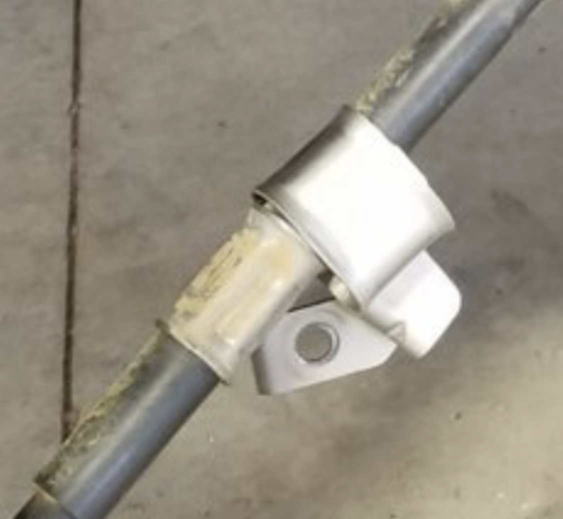

    not finding much useful info. What did you guys do with the brake line bracket nearest the rear axle?
    have a few ideas. Curious what y’all did.
    Thanks.

    for the parking brake cable, i just took the nut off the front spring clamp and put it there. I think i might have had to drill out the little bracket a bit. no issues. I paired my RXT's on stage 2 with FOX 2.0 DC's which allows me to better adjust for riding on stage 2 empty vs various loads/trailer. i can get it to ride about the same in many different combinations.

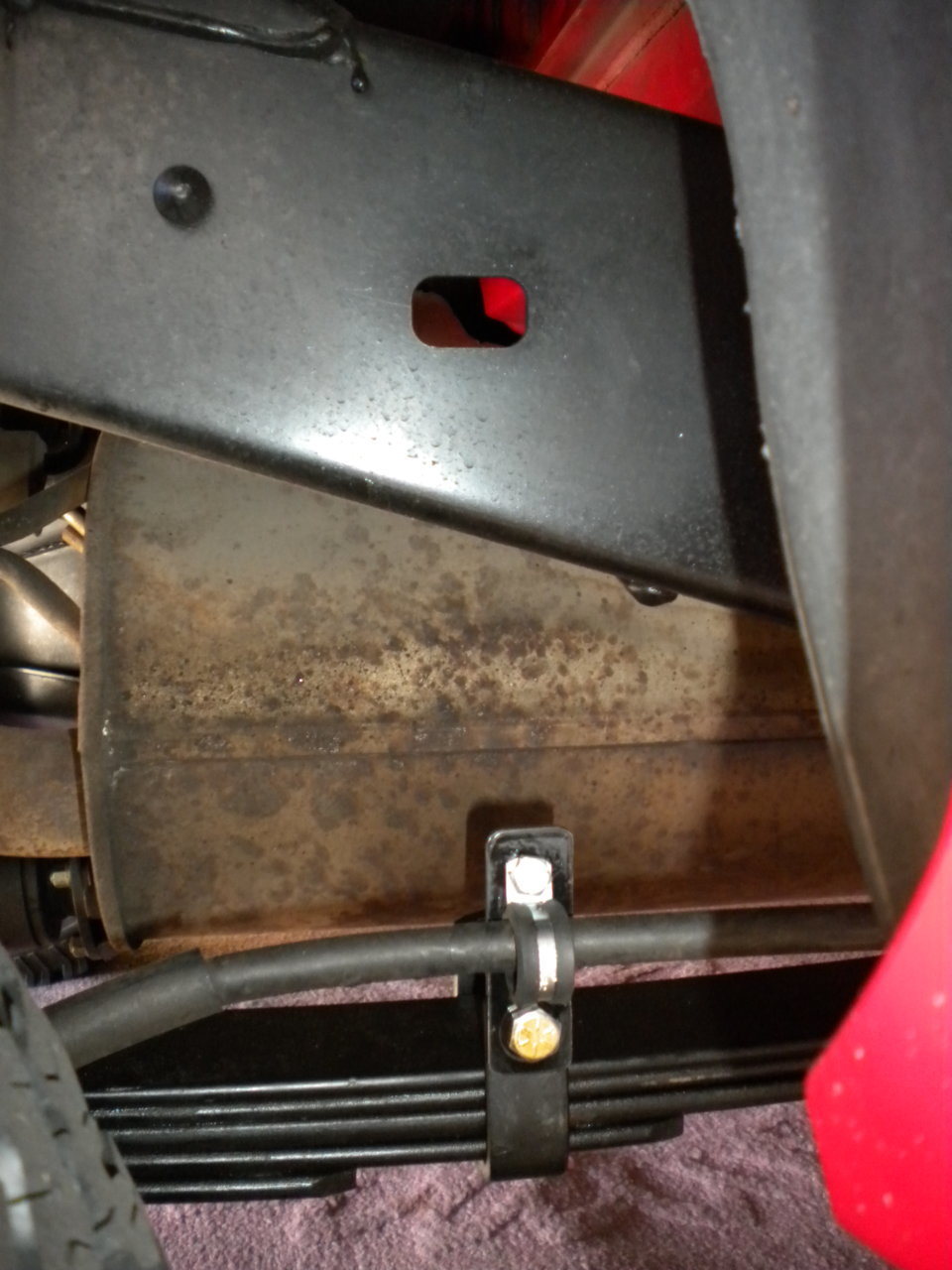

    Option 2 on the RXT's on my 2nd gen... have a canopy and carry 200lbs of sand in the winter. I've read with weight some experience sagging pretty quick with option 1. Truck rides great (Icon Stage 8.) Made a bracket for the brake cable...

    When I installed my stage 1 I just cut the bracket off, others on here have done the same

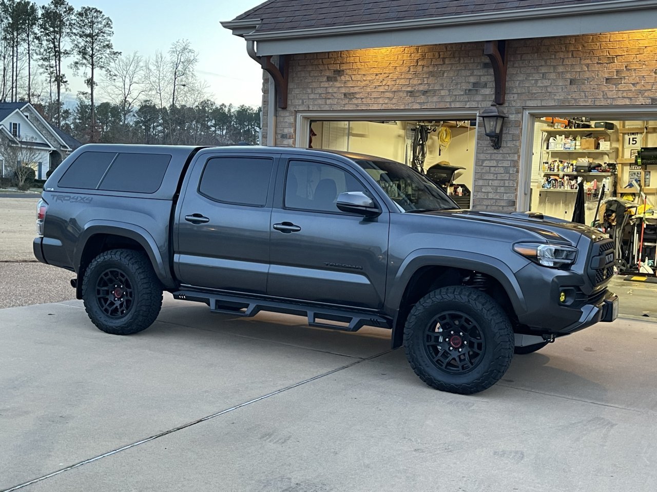

    It’s at 23.75”. 39” from the ground. Prior measurement was 36.25” from ground
    I don’t know how much it will settle, but Emily driven it 15 miles since I put it on yesterday. No weight yet
