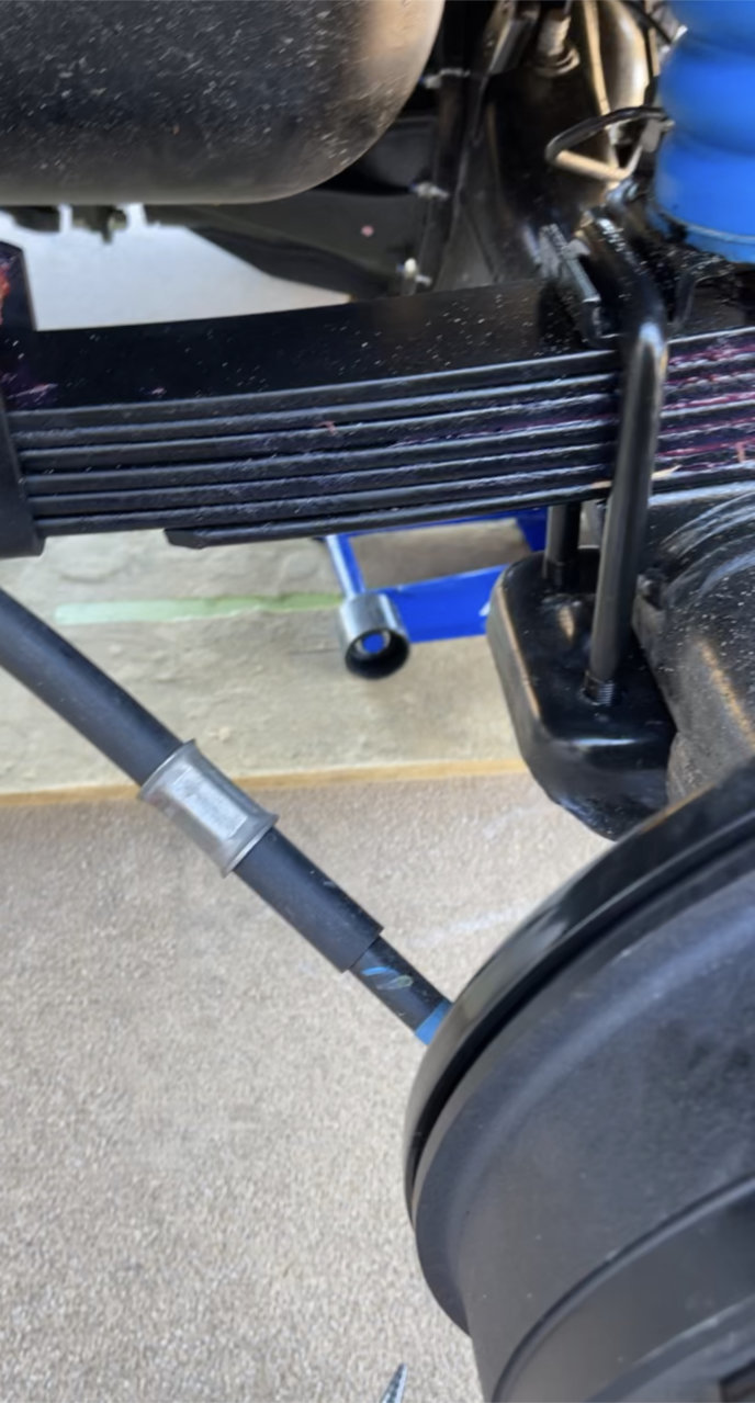

    I have stage 3 set up. I have about 2.5" of lift on mine but I am quite heavy. Topper, full skids, sliders, rear bumper, decked drawers, and topper rack w/spare. Mine took about 3 weeks to settle fully. You'll probably need to drive it a decent amount to help with that process too.
    Just cut those brackets off. No rubbing from me and I run pretty regularly through some decent trails.

    I just did the Icon AAL temporarily, when I get a new full pack I'll be doing shackle hangers at the same time. I cut the bracket off as it would be too tight when reattached and likely rip the line up.

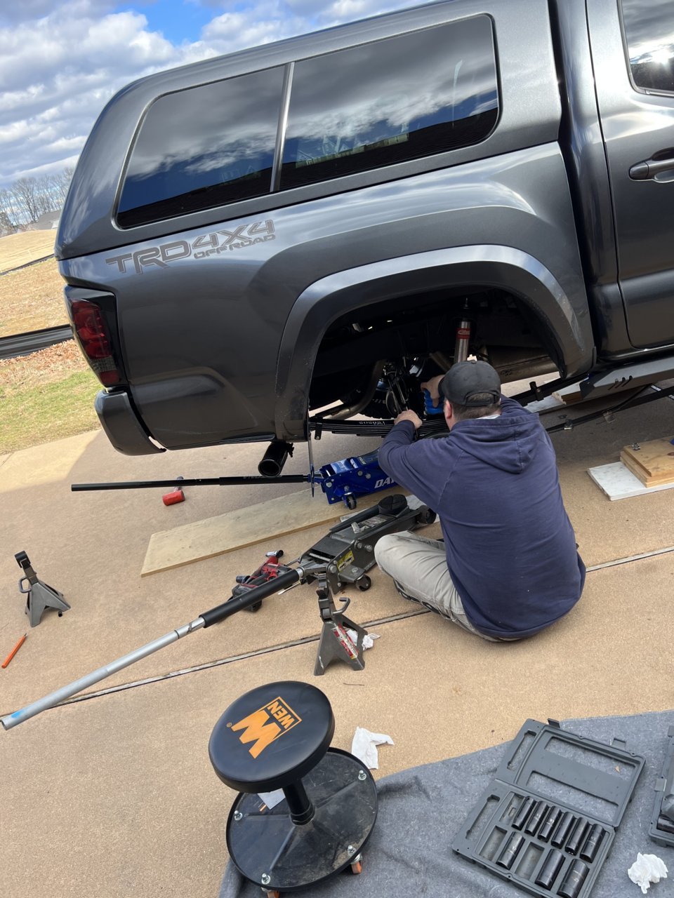

    Adjusted the front suspension some to sit right against the lift the leaf packs added. Sits great. Will wait for packs to settle and adjust if needed. Forgot to take pics of truck lol. Forgot to mention sumo spacers are on order

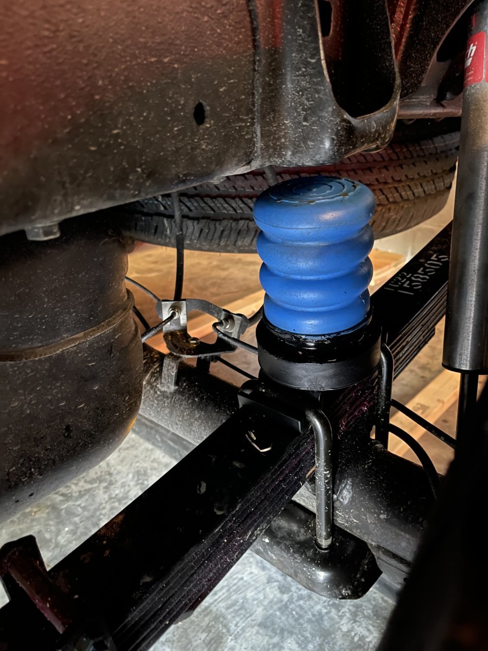

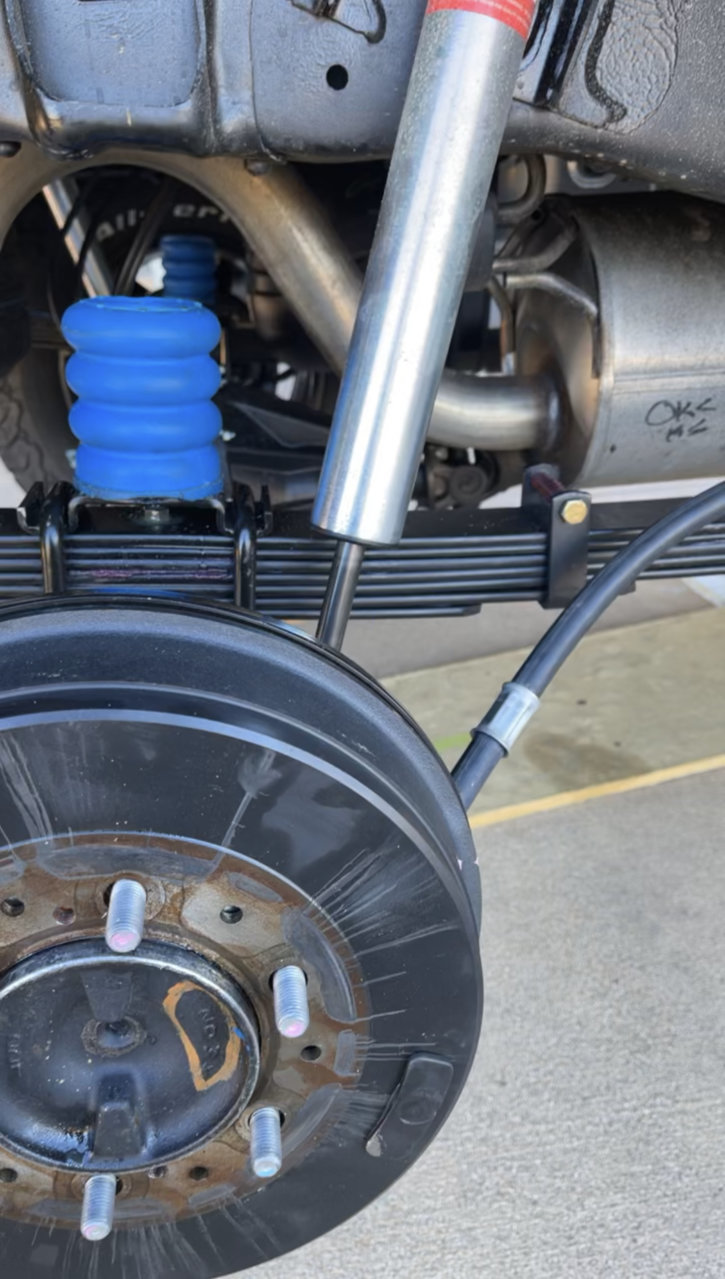

    Looks like you need the sumo spacers, they are far from ever being useful, that far from frame. Guessing you have jack still under axle?

    Yeah spacers are on order. They were perfect with old spring pack lol
    in that pic I cant remember if it was still jacked and on stands or not.

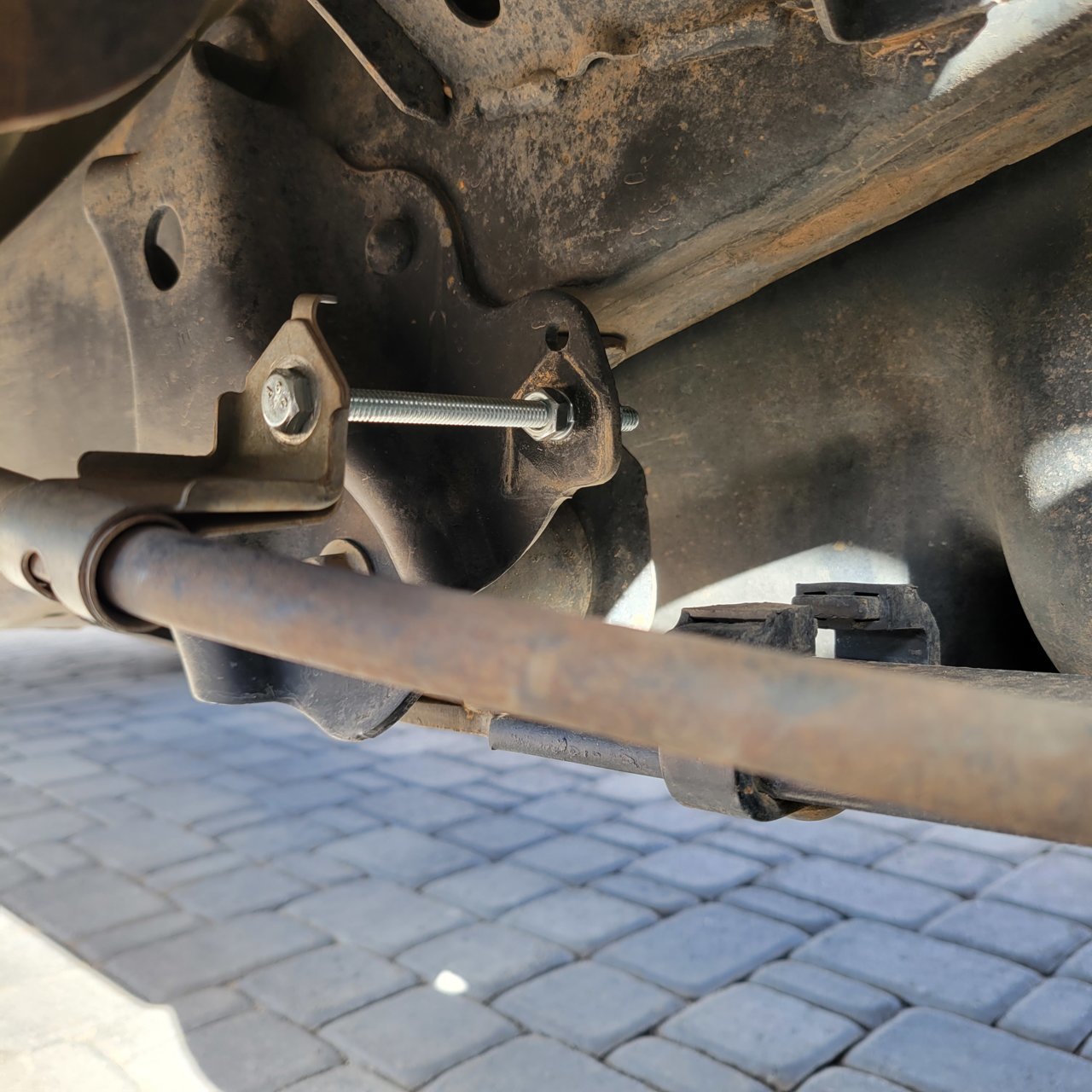

    I followed Icon instruction to cut bracket off because it had too much tension. That resulted in the line rubbing against the keeper and causing wear. My fix is a 4 inch bolt, three lock washers, and three nuts in the next bracket forward. One against the bracket to hold it in place with the bolt head, then one on either side of where the bracket attaches to the frame. Gives enough space so it can move around all it wants and doesn't come into contact with anything, and because it's a bolt you can adjust it in or out to get it just right.
