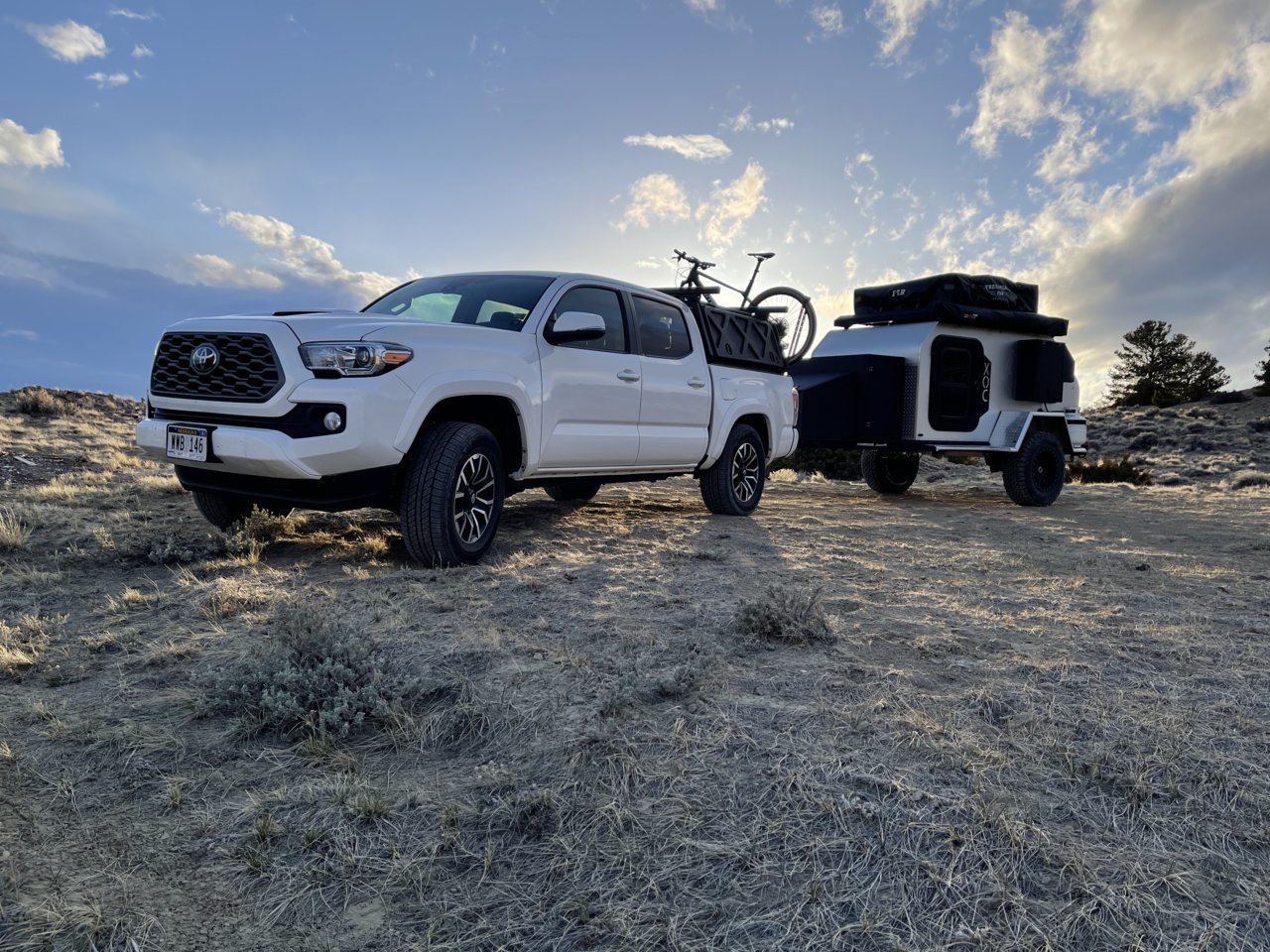

    Don't be afraid of high RPMs. These 3.5 V6s generate more horsepower than torque and peak numbers come at near 5k RPM. I have had my truck in S2 on the freeway at about 4800 RPM for a brief stretch over a few passes in New Mexico and Colorado. I tow 3500# regularly.
    Yep, 5th is an overdrive as well and if you have a Trans temp monitor you will see the temps skyrocket if you are in S5 or S6 and the truck is working to maintain speed. I only use the OD gears on long, downhill situations and rarely use 6th. Oly time in recent memory when I used it was on the down hill side of a 2000 foot descent. 4th is my go-to and I have done multi-state trips at 3-3.2k for days on end without issue. Your taco can handle it although the MPG will suck (8-12 avg depending on terrain and headwinds, no joke 8 MPG so be ready)
    A good rule is that if the truck has to work to keep up speed it should be in S4. Relaxing or coasting with a nice tail wind sure, put it in S5 but as soon as the truck starts to work and generate friction (heat) in OD the temps blast upwards in a hurry.
    Enjoy the boat! Sounds like you are the friend to have :thumbsup:
    What I tow... 3500# GVWR ... about 2800 pictured
