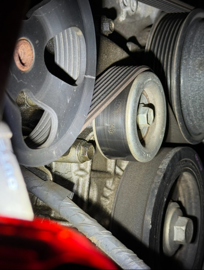

    Photo attached. It is hard to see but visible behind the belt. As I mentioned in the original post, I would not let them pull the engine for this even if they had said it was covered under warranty.
    The next closest dealer is more than 100 miles away and would not be worth my time.
    I have a couple long road trips planned later this year and do not intend to keep this truck for more than another 2-3 years. The idea of sealing it from the outside is something I am considering to prevent it from getting worse and losing oil between OCI, and to give me peace of mind when driving long distances.

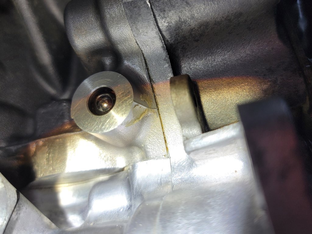

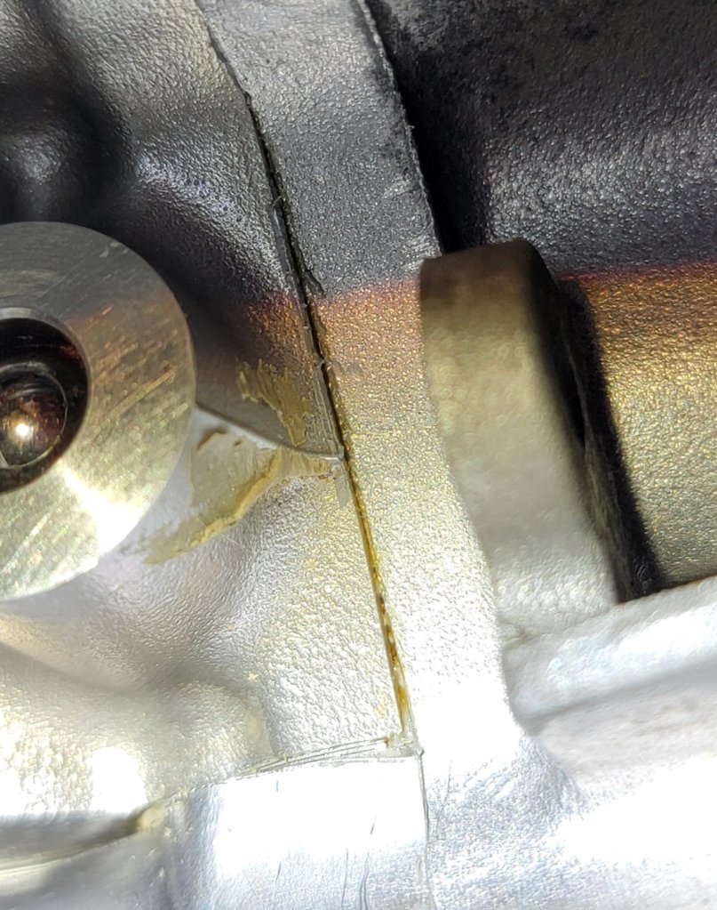

    The whole front end, and whole cover? I mean, I guess that's a good idea/practice, being a shop and applying due diligence. But all the info I could find, pointed to that one specific area, the seam directly behind the ps pump. I heard a post or two rumoring a possible leak location on the driver side somewhere, but couldn't find any real evidence or 1st hand experiences of that online myself. Maybe I didnt look hard enough idk..
    Not saying this isn't the way. Just might be overkill for someone not as inclined, or willing, to tackle such a job, doing it that way. But I would like to assume, that you're ultimately trying to convey (like me); that sealing externally is definitely a solution..
    It just seems like the op might be struggling to comprehend the situation as it is, so i just wanted clarify, that for the vast majority of these leaks/seeps, it would be located in the seam directly behind the ps pump, next to the galley ball plug.
    To be safe though, your first step should be to locate the leak before proceeding. I cleaned the entire area prior to sealing. Removed the pump, liberally cleaned it, reinstalled pump. I also used some dye in the oil. Drive it for a little bit, then pull the pump again and inspect. Locate the leak (my money is on this seam), and continue with the typical seal procedure to the affected area (making sure your scrape the old rtv off and get the area VERY clean this time).

    Yeah yours isn't too bad given the mileage. I wouldn't sweat it. Just FYI they don't pull the engine for this fix anymore - now they drop out the steering rack and front diff for access.

    The OP's really isn't too bad tho. Doesn't appear to be more than a few drops over 3+ years and almost 60k.
    Mine at 4.5 years and 55k looked much worse. The whole front passenger side of the engine was coated in oil but it was never enough to drip into the skid plate.
