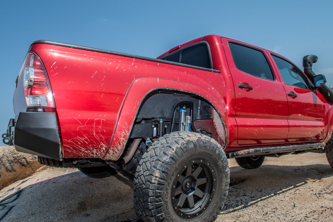

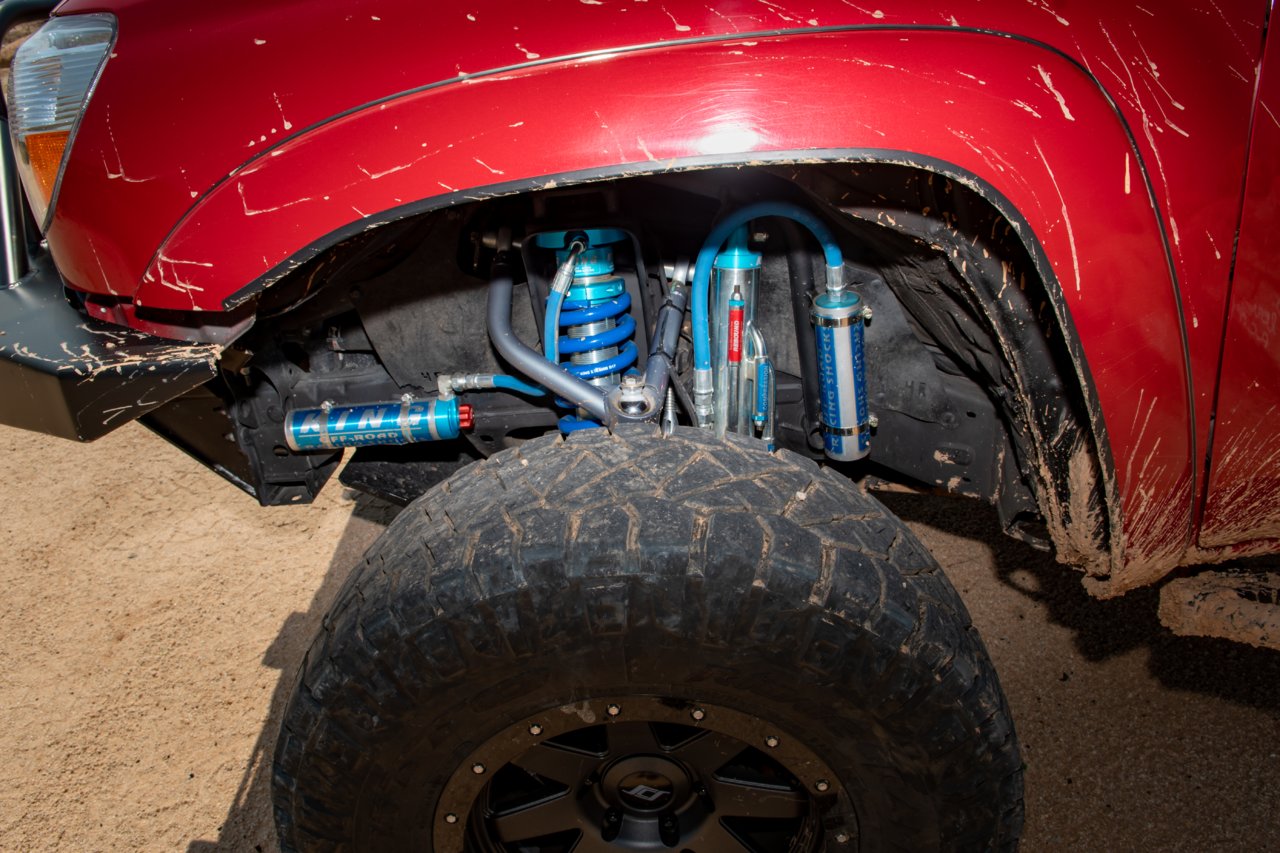

    I did 3" in the rear and 2.5" up front-but because of 34" tires and +2 LT
    combination of tin shears, dremel, body saw.
    used a more matte black trim found at O'Reillys in 8ft length(?) sticks ok to the flare but gauge of metal pretty thin. I used clear gorilla tape at various spots to keep it attached on the metal fender. Flare seems to be holding up but because of the wind drag and lack of supports from the bottom because you cut the screws mounts away, I had to use JB plastic weld where the clips mount in to the fender flare.

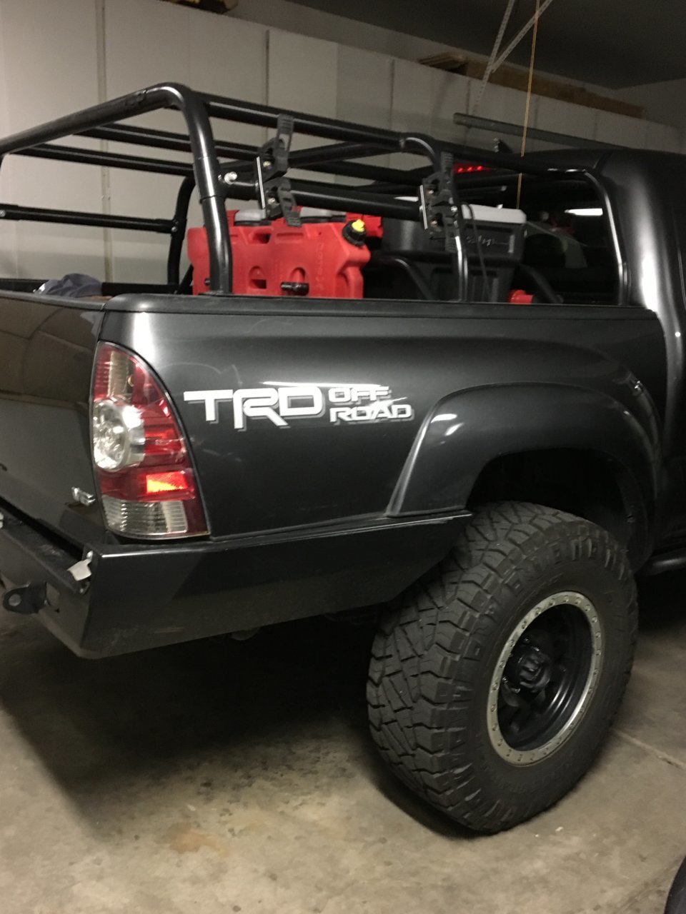

    EDIT: I am not sure that I have seen a taper fender/flare trim. I am not sure how clean it would look also. I have seen people lop 2" or 3" off the bumper, weld it back together and then just trim the fenders and flares 2" or 3" to match the lines.
    IMHO the latter is cleaner.
    My HC rear was purchased from Pelfreybilt with the 2" removed with 35's in mind.

    The 2nd photo is what I was referring to in that if I trim 3” off that I would taper from 3” to 0. Yours is a different situation without the bumper modification. Nice suspension you’re running there.

    Lift man, thanks for the links. So you had pelfrey shorten the return on the bumper you ordered by 2” taking into account 35s you were running?
    So my assumption that pelfrey bumper was sufficiently short enough at full stuff running 35s was wrong? I too have never seen the taper back to 0 , I was questioning how it would look and baffled how I would pull it off for that matter. I’ve seen a lot of photo here on TW with trimmed fenders/flares and until I saw everyone’s method of tapping off and marking the cut line I realized the cut would end up behind the bumper return ending point.

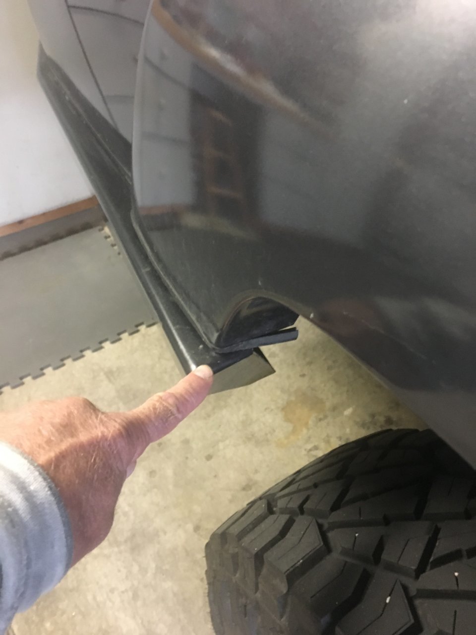

    I don't have pelfrey bumper but I did taper my rear HC. Don't think it turned out too bad, and clears 36s with no problem.
