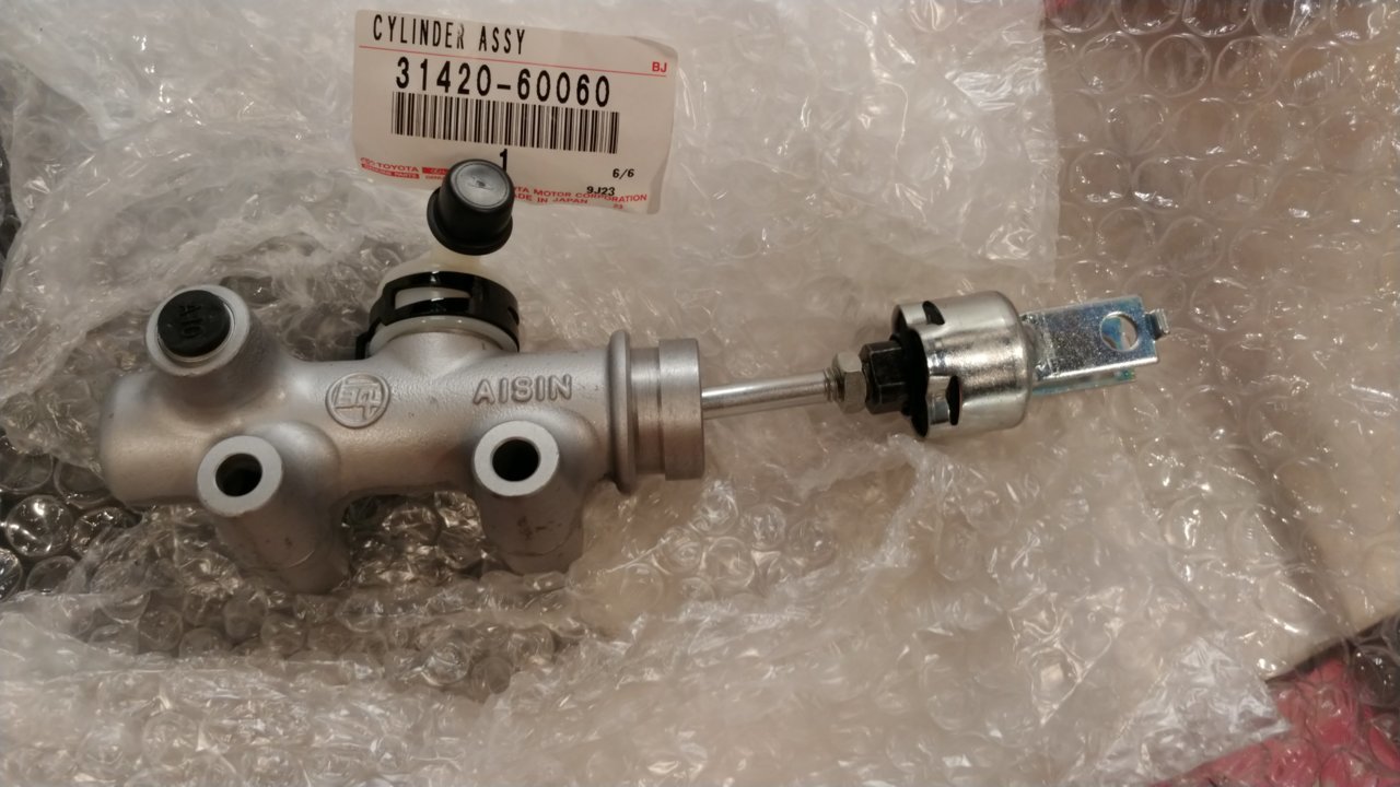

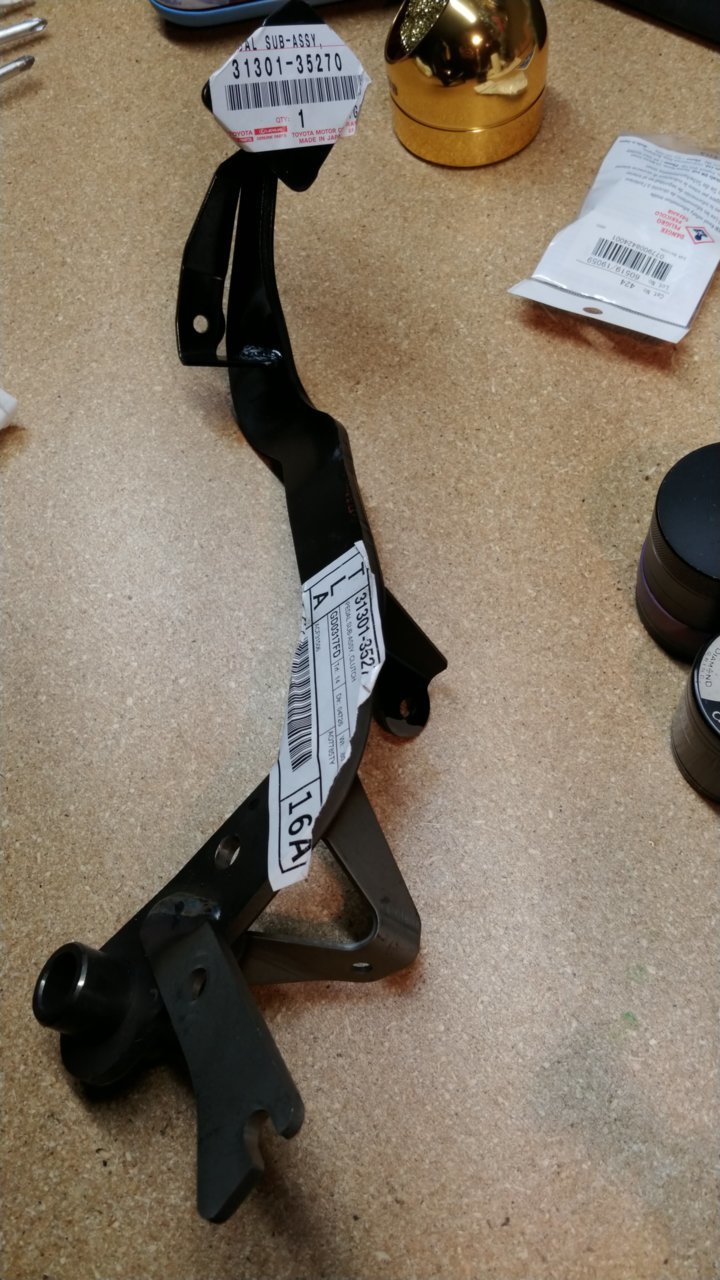

    i did a return spring delete for a few months. that didn't do much of value. about to replace all this junk with the all metal FJ pedal assembly and 2008 LC MC. none of this plastic crap is worth reinvesting in.

    there's been discussion here & there among a few 3g MT guys about it. it has been done in a 2g truck. but not exactly like this. i may eventually put up a parts guide for it. but this is to replace all plastic with a full metal solution that won't groan, crack, break, or be stuck with play forever. the later model MCs have a plastic clevis and so thanks to parts guru Jeff Lange we got the info, which requires the MC from a 2008 Land Cruiser. i have it all ready to go, about 17-18 parts total iirc. looking like next year i guess.
    i have been dialing in the drive experience details on my truck for 3 years, and this one has become the elephant in the room that just needs dealing. IMG_20191105_090446.jpg IMG_20191112_204625.jpg
