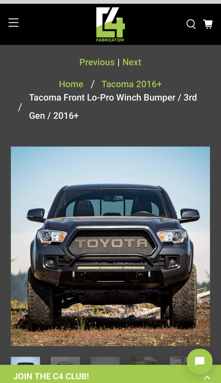

    Good afternoon, I’m getting ready to purchase the C4 low pro winch bumper but can’t decide if I should go clear or an amber light bar? What are the benefits of going amber? It’s a little more expensive if I went with amber.
    Also, what do you guys recommend for a winch? Pulling capacity? Brand? Cable or synthetic?
    Any input will be greatly appreciated. Thank you.

    I’d recommend a 9500lb winch with a synthetic cable it should have enough pull power to get you out of anywhere and the synthetic cable is a little safer as for the lightbar amber is better in fog

    Amber lights are ideal for foggy situations. However, you can't use them on the road, or you'll blind people. Assuming you're not in to blinding people, you'll be using these offroad. Do you foresee yourself doing a lot of late night offroading in the fog? If so, then get amber. Otherwise, clear will give you better light range.
    Or if you're in it for looks, I think amber looks pretty snazzy.

    For the lightbar I don’t have to do any splicing of factory wires do I?
    On C4s website one of the options is the S8 BD lightbar.

    Nope should be able to directly connect to battery and run a wire inside the cabin

    Just make sure it comes with a wire harness most do

    I went with the lo pro, and pulled the M8000 off the Gen1 and rebuilt it, spooled with new synthetic.
    You should think for sure about going with synthetic. Safer, and lighter. My C4 lo pro with M8000, synthetic, and Baja Designs S8 light bar weighed in at 145 lbs. Steel cable weighs about 15 lbs. That's all a lot of weight off the nose of the truck.
    What suspension / coils you running? You'll need 650 pound plus springs. I went 700 lb coils on the Kings, and it rides and handles great.
