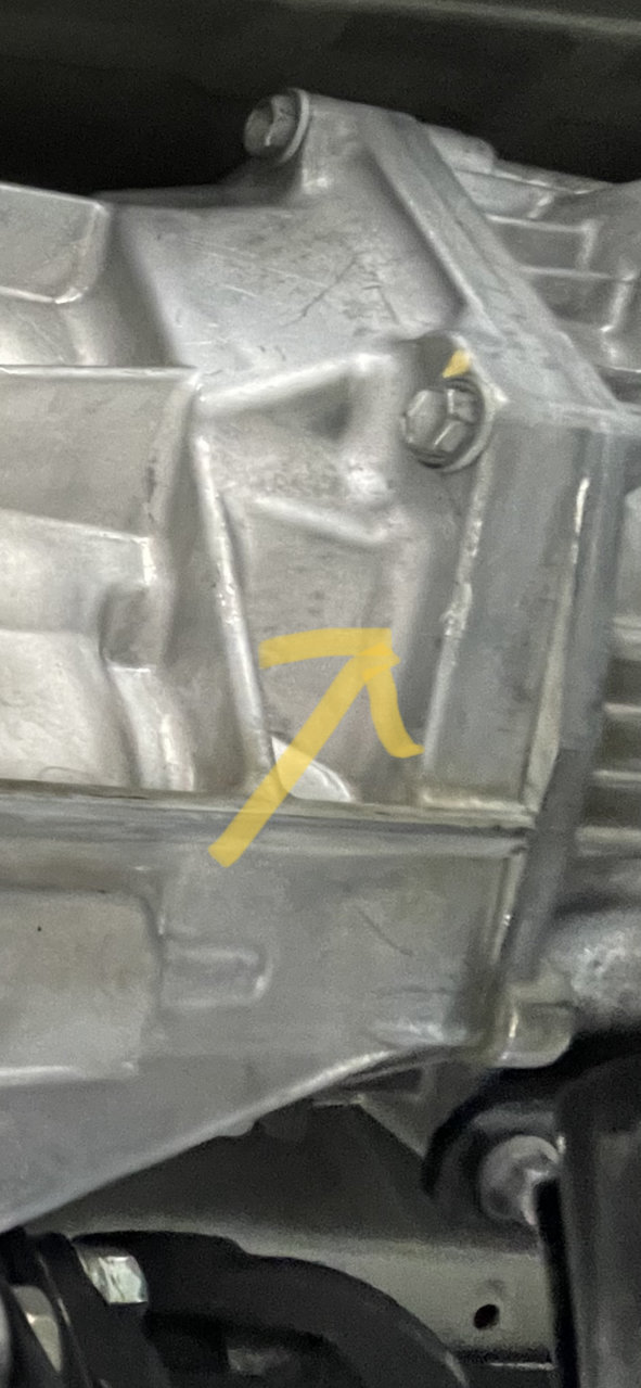

    Got it, what does it really mean when those weeps and seeps are documented? Just watch and see if it gets worse? If not, then ignore and pretend all good?
    Although weeps and seeps are slow, I assume that some fluid is lost, should I then try to change and refill the T-case fluid or MT fluid more often just to ensure I'm not running low?
    Natetroknot likes this.
  5. Apr 19, 2021 at 10:17 AM
    #25
    tonered
    tonered bartheloni
    Sep 25, 2017
    #231055
    31,272
    tony
    Lynnwood, WA
    If the dealer documents it and it gets worse, esp out of warranty, the fact that it was documented early allows the repair to be covered later.
    Weeps are deceptively small. A little bit of fluid can make a big mess while not affecting the actual, safe fluid level.
    On the MT, checking fluid levels is crazy easy. Just pull the fill plug and see how much is in there. Typically some will run out, or you can use a bit of wire as a dip stick.

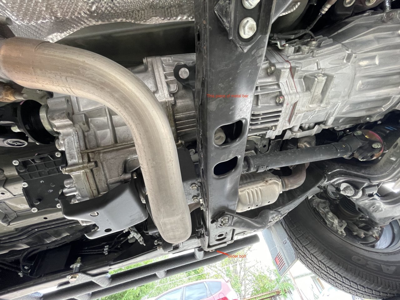

    Well, to be honest I hope it's a simple fix. I just put on the sliders and they are bolted on part of the cross member bracings.
    If they have to take out the cross member bracings to repair, then they will have to remove the sliders. The sliders are such a PITA to put on.

    looks to me the piece of metal bar is directly below the MT and the slider bolt is on that piece.
    I guess if all the work is done on the transfer case then probably can leave that bar alone
    but judging from the fact that the MT area is wet too, I think probably they need to pull out the MT and hence removing that metal bar, or there is another way to get the MT out?

    Don’t get too far ahead of the diagnosis, like you said it could be a simple fix.
    You could remove the sliders prior if it would mitigate stress about it but I say send the truck as is and let Toyota’s warranty take care of you.
    People have been putting in running boards, nerf bars, side steps and sliders a long time and the techs roll with it.

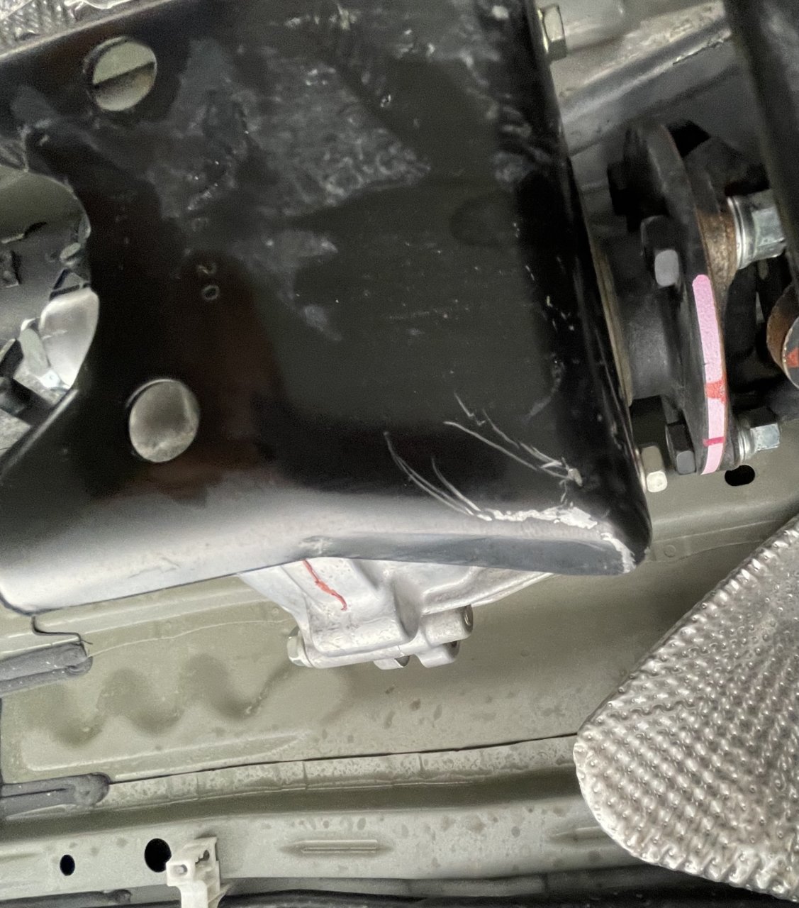

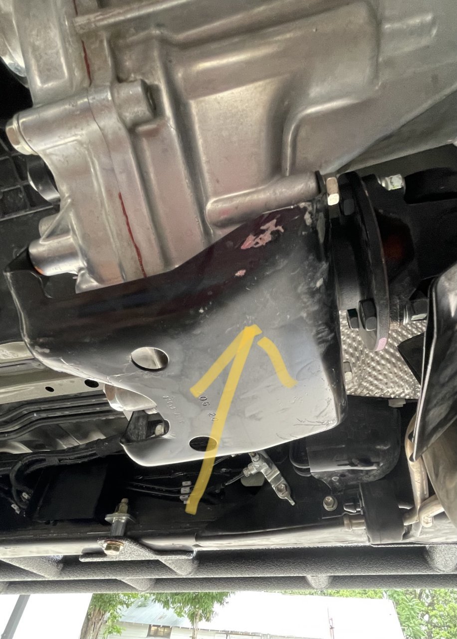

    oh well, I'm not familiar with the procedure, but I can't help wonder how changing the seals would involve scratching so much of these things
    these are what looks like after dealership finished the repair
    are these just cosmetic damages by wrenches or sockets? Or the transfer case dropped on or impacted something?
