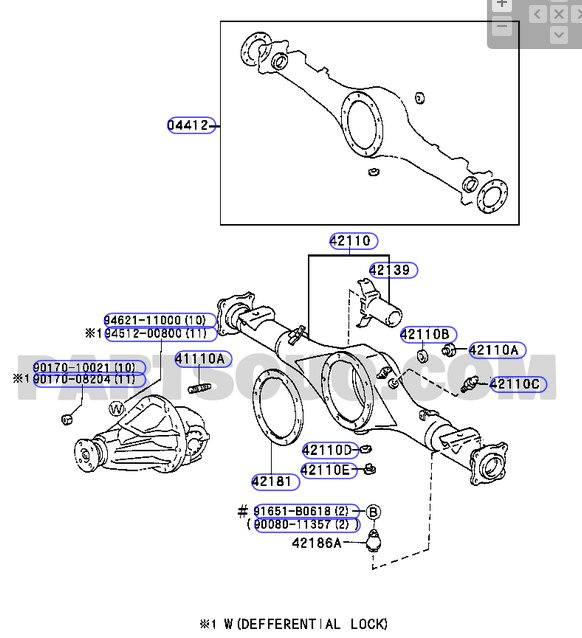

    (I have a query in to EastCoastGearSupply inquiring if I can remove my e-locker and install a TrueTrack in my rear e-locker differential housing (3rd member?). I think the answer is, "NO" but their web page for a TrueTrac for a Toyota Pickup & 4-Runner - TT 913A610 (Toyota TV6 Rear Detroit TrueTrac 913A610) seems to reference a Toyota 8" V6/Turbo/E-Locker rear end. Erik's Toyota Differential Info page seems to suggest the 8" V6/Turbo/E-Locker axle / 3rd member is identical?)
    If I cannot install a TrueTrac in the rear diff housing (3rd member), will an 8.4 3rd member properly mate up with rear axle housing assembly (p/n 42110 in the illustration below)?
    Or do I need an 8.4 3rd member with a rear axle housing assembly from a 2wd and 4wd T100, '00-06 Tundra (possibly Sequoia), Tacoma non-TRD 4x4, Pre-runner, or 4x2?

    I can't answer all of your questions but the 8.4" third member will not bolt up to the e-locker axle. They have different bolt patterns.

    Is it just the 3rd member, or does it have an axle housing (p/n 42110 in illustration of post #1 above) too?

    It's the entire axle and 8.4" 3rd member
