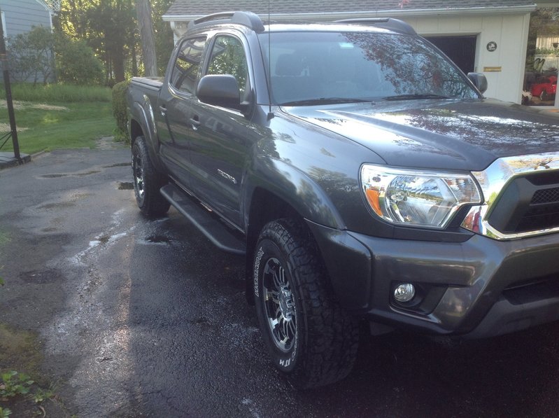

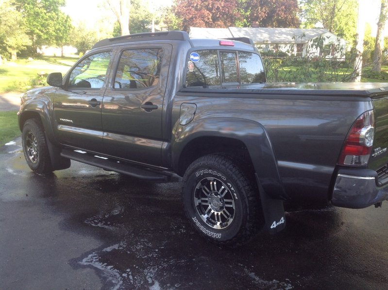

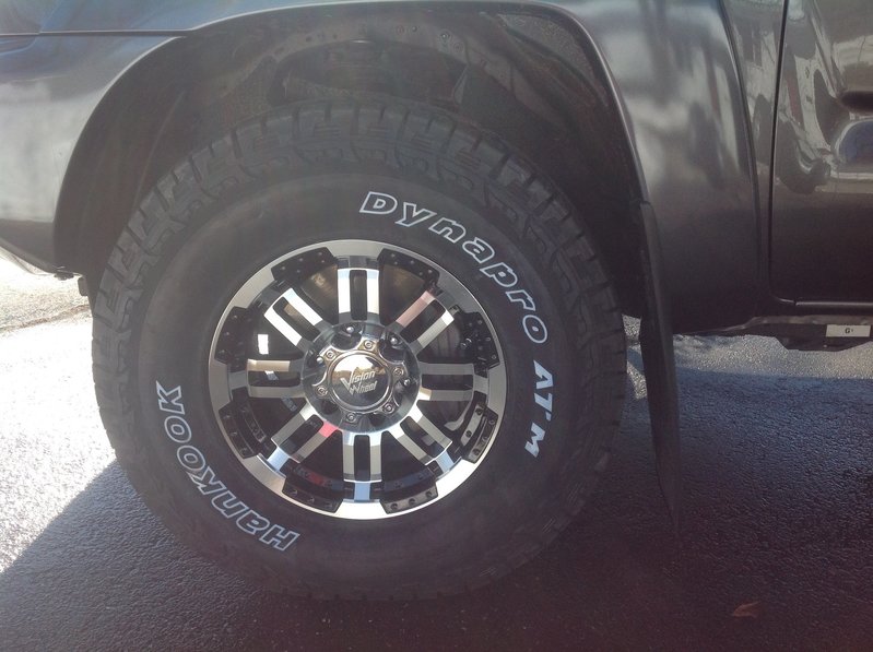

    You happen to have any photos of your truck on stock suspension after getting the bigger tires? I'm trying to decide 265-75 vs 70's.
  19. Dec 3, 2015 at 4:10 PM
    #19
    vssman
    vssman Rocket Engineer
    Jun 17, 2013
    #106440
    10,042
    Paul
    Naugatuck, CT
    2013 SR5 double cab
    Here's a few...
    NMTrailRider likes this.
