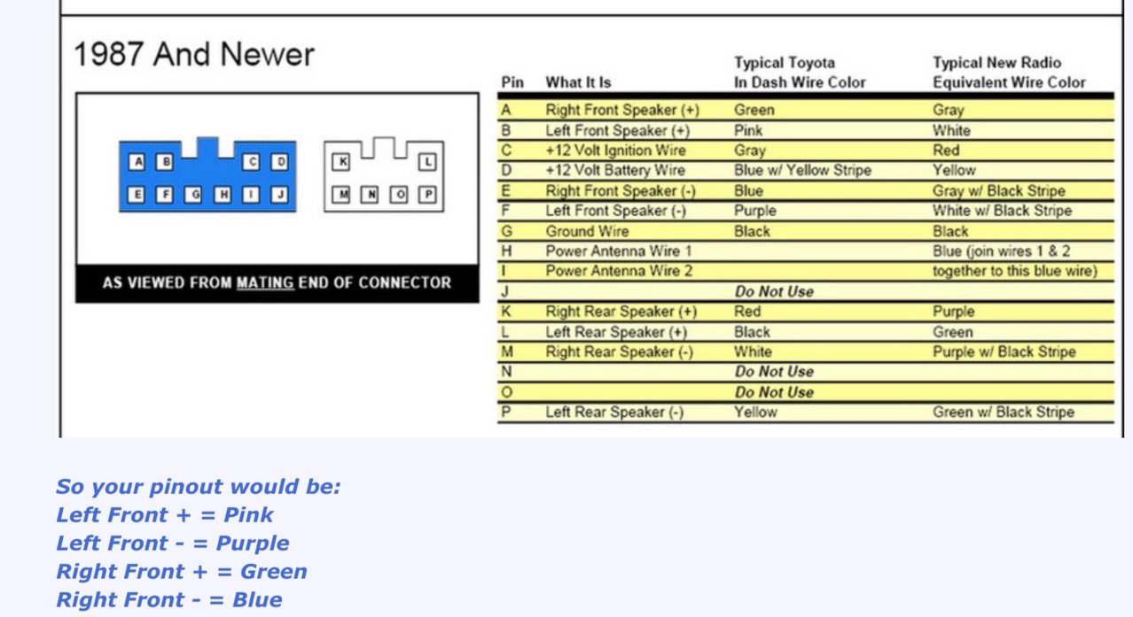

    Am I correct assuming that there are only 4 speaker wires in the rear plug of the HU
    (Front L & R pos/neg) on the Regular Cabs?
    If so, the Key has 4 RCA plugs on the input harness and the instructions say to cut them off for high level input which leaves me with 8 wires total.

    They will go to amp 1 (front) and they will match the standard wiring colors on the included harness with the Key
    (Standard colors being
    Front left - white
    Front right - grey
    Rear left - green
    Rear right - purple
    All positives are solid, all neg are black striped)

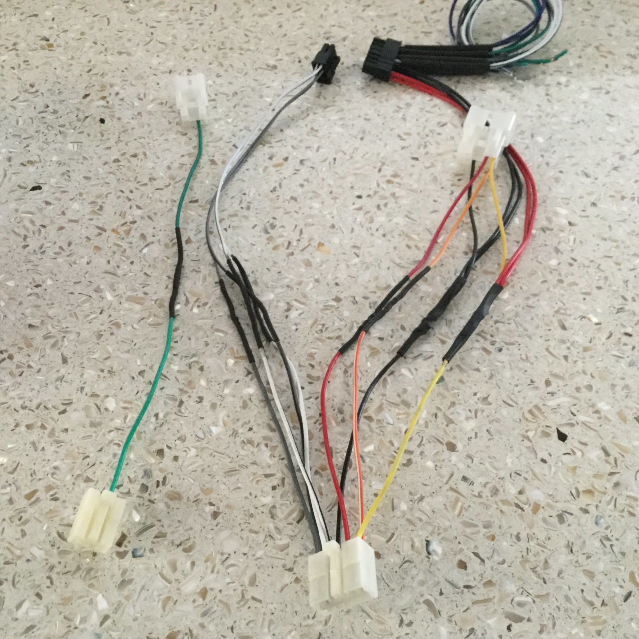

    Finally got my harness for the Key put together using the Metra adapters. The Key is installed behind the head unit (Used Velcro) and wired up to new speaker wires going to the doors. Still need to install deadening and speakers.

    Quick question for you. I followed https://www.tacomaworld.com/threads/tpp4s-no-nonsense-guide-to-kicker-key-t-harness-16-19.642415/ to make my harness. Should I use these settings? I have a non jbl system and I don't have a sub.
