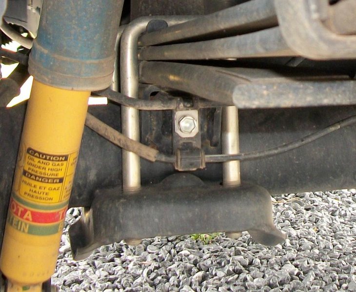

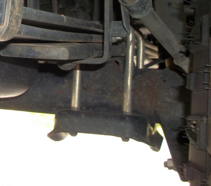

    for any of you that have added a leaf, i need your input. a big brown truck dropped off my 2" AAL earlier today. i want to get it put on ASAP but i need to know if it can be installed without new u-bolts. i didn't think about this when ordering these. i have read that some people have done it without new u-bolts. but i want to know first hand from any of you that have had an AAL installed or know for sure that somebody has. please reply if you know, because if so, i am going down to my mechanic first thing in the morning.
    thank you
    EDIT: i have the non-TSB 3-leaf pack if that will help any. and i added pictures, idk if they will be any help.

    Compare the thickness of your new AAL, to the amount of available threads showing on your rear u-bolts(The pictures don't show how much thread is left on the u-bolt). You need enough threads to accommodate the AAL, and still have some threads showing on the end of the nuts. Usually they are long enough. Hope this helps....

    thanks man. yeah, those pics weren't really taken for this, but i couldn't really get out there and get a shot at midnight, so i cropped another picture i already had. but if they are usually long enough, then it should work. thanks.
