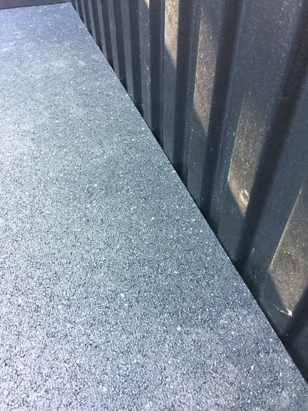

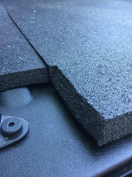

    Thanks for idea of using a horse stall mat. I got mine from a place called Atwoods for $32. Used a jig saw to cut, it was pretty easy. I cut the back edge at about a 40 degree angle just to ease loading. The mat is only 48" wide so you have to cut a small piece for the corner.
