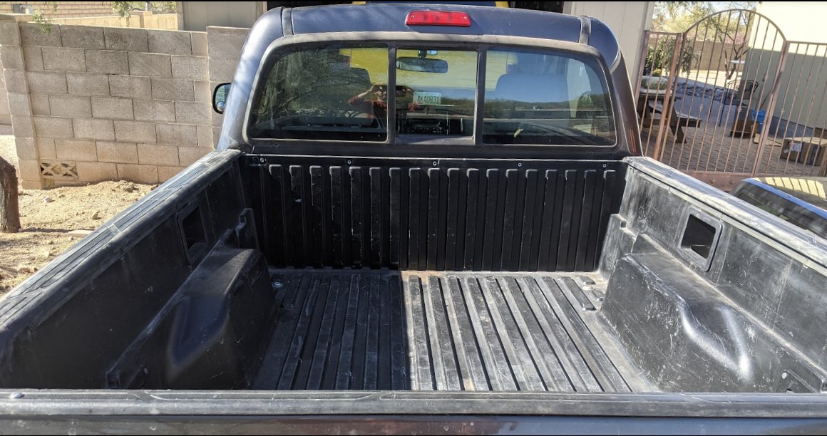

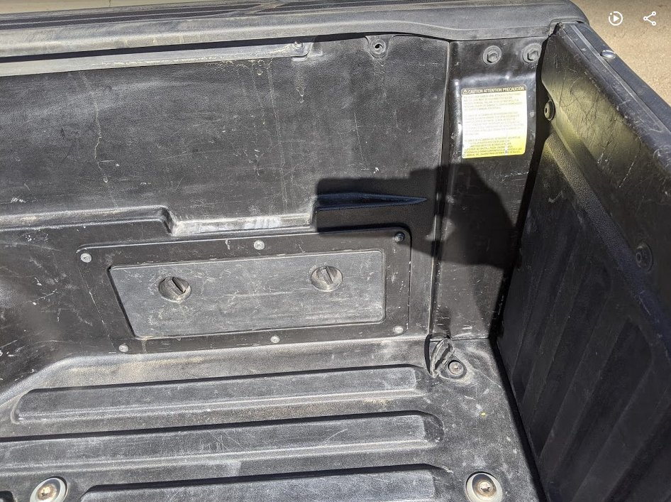

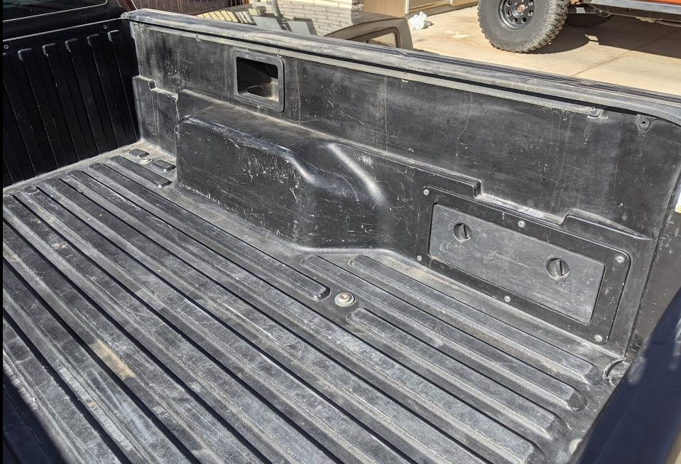

    Interesting! I had no idea it was a factory option. Yes, 2011. Here are some pics.

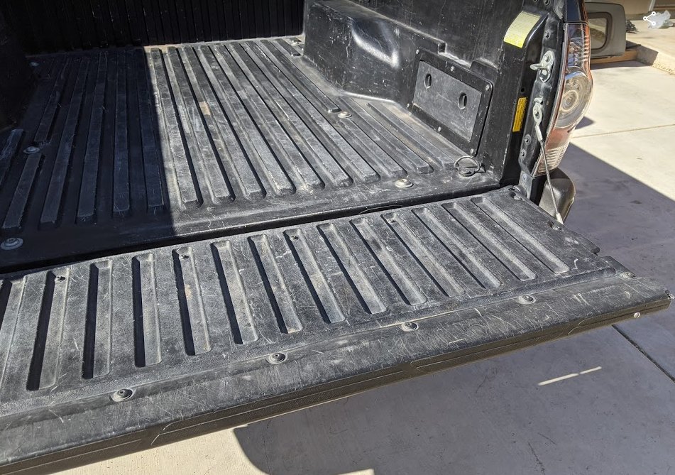

    The tailgate has some sketchy looking flathead screws holding the plastic at the top. I can't believe that's factory?
    So regarding the topper mounting, the new person could just clamp it without any rails, no problem?

    Did you take the tracks off? That's the factory cargo management track- put it back on. There should be one across the front too. The tailgate bolts are factory as well. They're screwed onto plastic inserts so if you take them out more than a time or two plan on buying new inserts.
    As to your question about the "bed liner", that is the bed. There is no liner on the newer trucks, it's a composite bed to reduce weight.
    Your truck should have come with four loop thingies (technical term- they're cargo tie downs*) that slide into the track, they may not have come with your truck or the previous owner may have stuck them in with the jack or something.

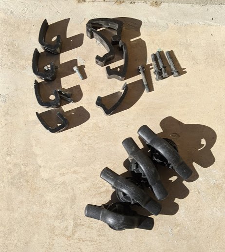

    Yup, I have those. Also some metal clamps used to hold the shell on, presumably not factory, but they were using the rail:

    Yep, those are the factory tie downs at the bottom of your picture. You can slide them on and off without removing the end caps.
    I would strongly advise your buyer to add an additional pair of clamps in the middle to apply more even downward pressure along the bottom. It's a PITA to get shells to seal properly on these beds.
