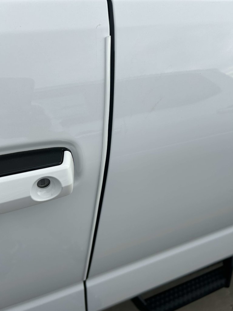

    My dealer has the exact spec manual Tacoma on the lot that I want, except it has the thick door edge guards. I hate they way they look. These are the heavier pressed on version. Has anyone removed these without damaging the paint? The only other posts I’ve seen on this and other sites are mixed.

    Don't let that silly edge guard stop you from buying your perfect truck :) The edge guards come with internal adhesive in the channel. You can remove it by prying/lifting the edge (with an old credit card or plastic trim tool) and spray WD40. Slowly work it loose and off. Then clean the WD40 with soap and water. Good luck.

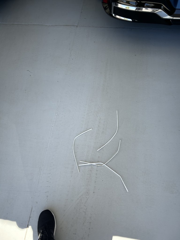

    They popped off with no issues or paint damage.

    Well, we’ve seen your door and garage floor.. Show off the rest of the truck!

    Don’t forget 1 shoe, we’ve seen that as well
