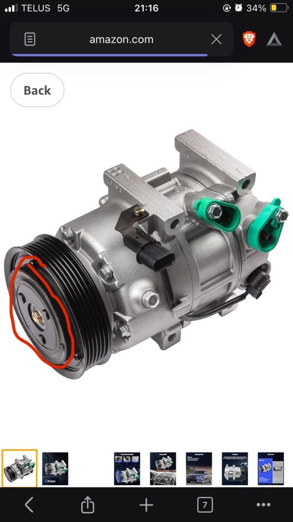

    Potentially...with the engine off, try to spin the hub part of the a/c compressor. I have the spot circled in red. The whole
    Middle part should spin with notable resistance but relatively easily. IMG_0650.jpg

    I’ll try that this evening. What does that tell me if it spins or doesn’t spin?

    That tells me that your compressor is locked up, but the magnetic clutch is good.

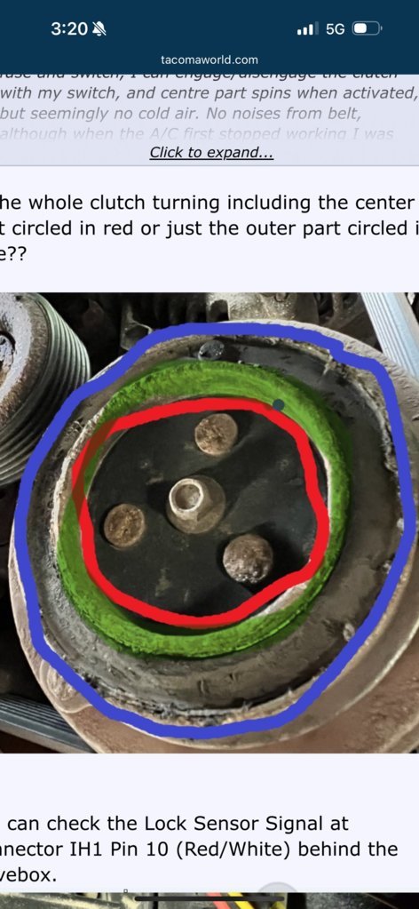

    So with the system charged and compressor in good shape, you should be able to spin the centre by hand with notable resistance but you shouldn't have to muscle up to spin it. It should have some resistance though and it shouldn't spin effortlessly though... if you have another vehicle for comparison with working a/c try it on that compressor first to get a feel for it then try it on your truck. Spin the hub atleast 10 continuous revolutions before making the call because sometimes it's just a bad spot in the compressor ruining everything.

    Okay so I went out to my buddies Tacoma a guy I work with his truck is here at work so I could try it. I wanted to try his for feel before I get home to try mine.
    I’ll post a picture below but his AC works of course and I was able to spin his 10 revolutions by putting my hand on the “green ring” o highlighted in the picture.
    I’m not sure if that’s the right spot you meant. I cannot turn his at all by holding the bolts inside of the red ring in the picture. Is the green ring what I wanted to turn?
