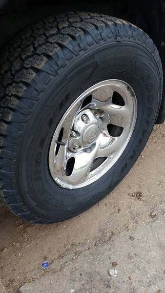

    These are the ones I have. I assume they're, what KBB calls them, the premium wheel option

    What is that below the valve stem, lower left? Did some shop put a weight for balancing on the outside of the wheel?

    Yep. That's how they did it before. Is it not supposed to be like that?
