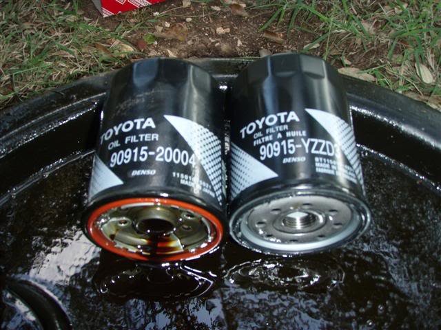

    The OEM (japanese, 20004) filter rocks. It's built like a machine part:
    The previously posted link has a link to toyota-specific filters.
    http://minimopar.knizefamily.net/oilfilters/toyota.html
    Even the smaller YZZD1 has WAY more filter area than any of the others. I think many of us are using the larger YZZD3.
