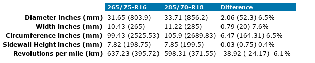

    are 285/70/18 basically 33's?

    Basically. Different manufactured tires will have different height sizes even thought they will all say 285/70-18
    from the online tire size calculator
