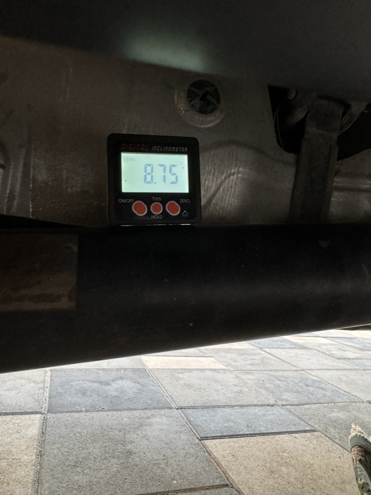

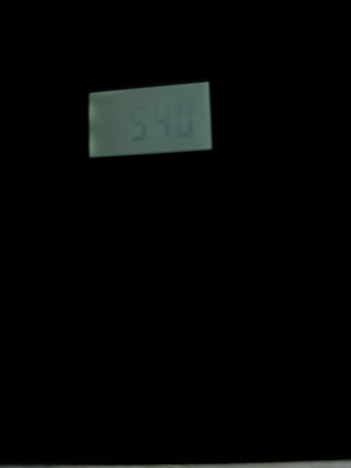

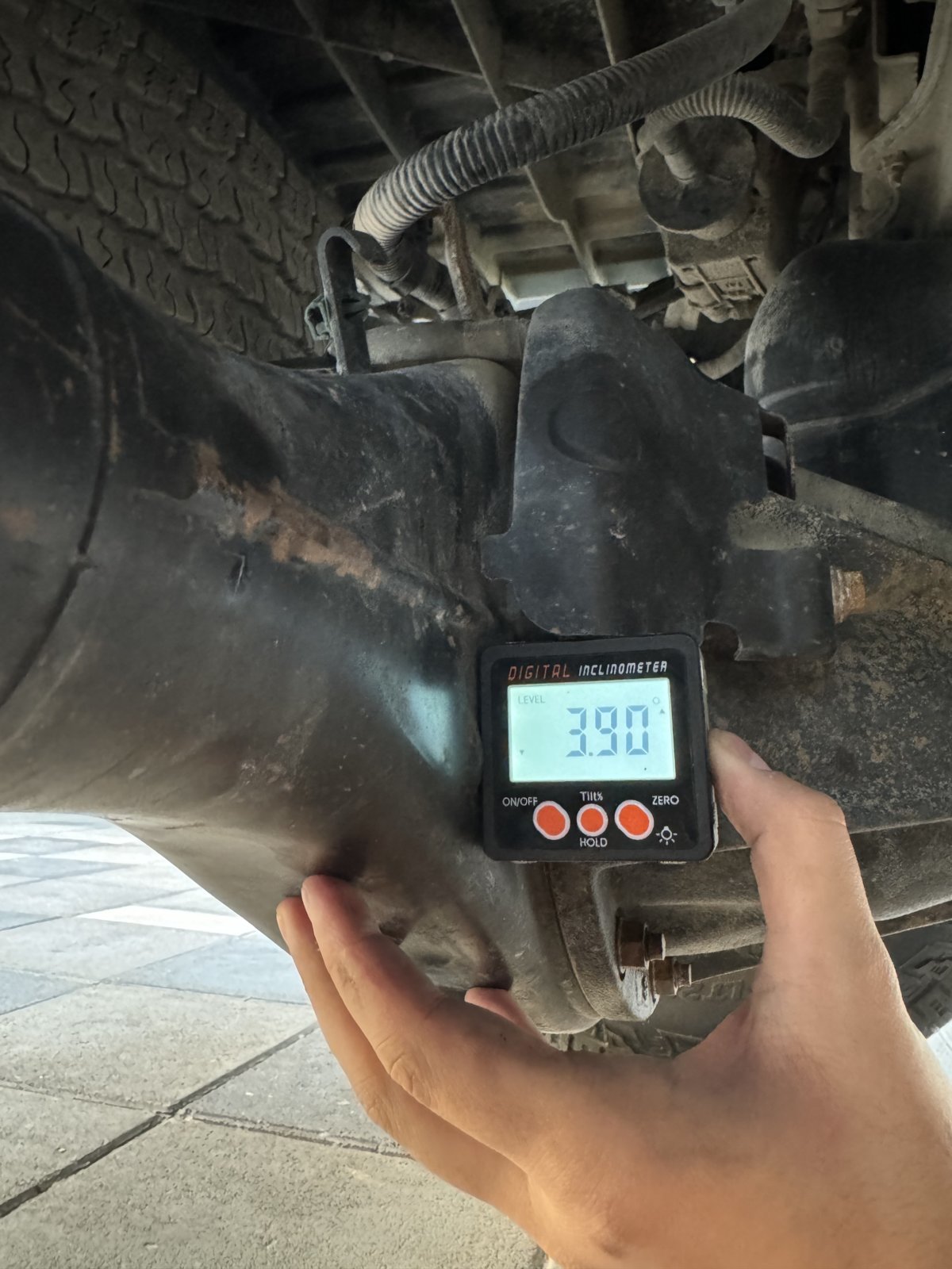

    I removed my carrier bearing shims and flipped it 180 and 90% of the vibrations i was getting at 20mph is gone
    This are my new readings of the angles
    Front shaft 5.40
    Back shaft 8.75
    Carrier bearing angle 3.35
    Pinion angle 3.90
    Back angle 4.85
    = 1.5
