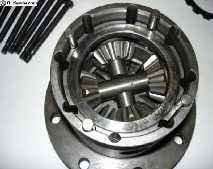

    ^ on the door jam on the driverside there is a sticker there, in the bottom right of this sticker you will see 4 digits like B03A which translates to 8'' ring rear,4.10 gears,2 pinion open. what does it say on yours?

    whats the difference between a 2 pinion open and a 4 pinion open?

    2 pinion..............see parts 9 & 15
    4 Pinion
