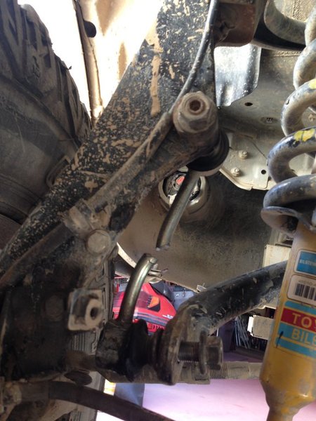

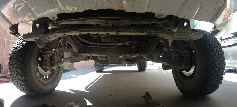

    I just removed my sway bar after snapping an end link in big bear...
    ...soooo I took it off :D
    BOOM!
    So my question is...do I need to get an alignment after removing this bad boy?
    Thanks!

    You shouldn't need one....go flex that biatch now :burnrubber:

    If you hit something big that snapped it you may need an alignment, but the sway bar itself has nothing to do with alignment. Not sure what front suspension you're running but you may want to move to something stiffer without the bar.

    So you still have stock front coils, right?

    That can be pretty dangerous in the turns or emergency maneuvers unless you upgrade your coils to something much beefier than stock coils. You can get a lot of corner nose dive. Recommend you practice a bit somewhere safe and away from other people and get a feel for this carefully, then replace it (the antiswaybar) until you get better coils.
    Quite a few threads discuss this, and I removed mine from my first gen, but I also upgraded to much stronger aftermarket coils.
