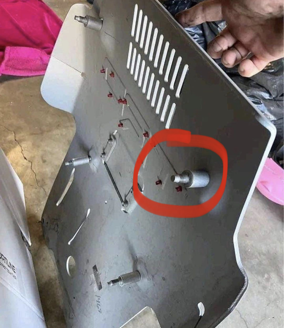

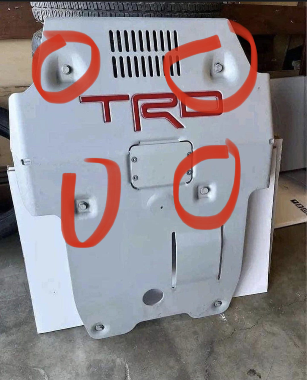

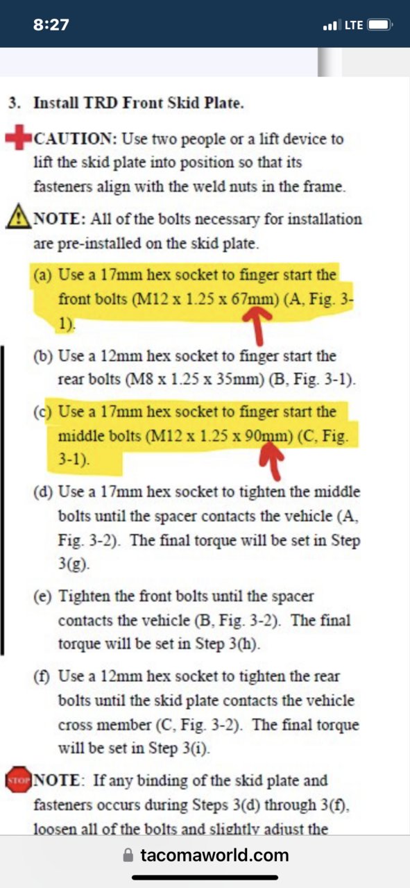

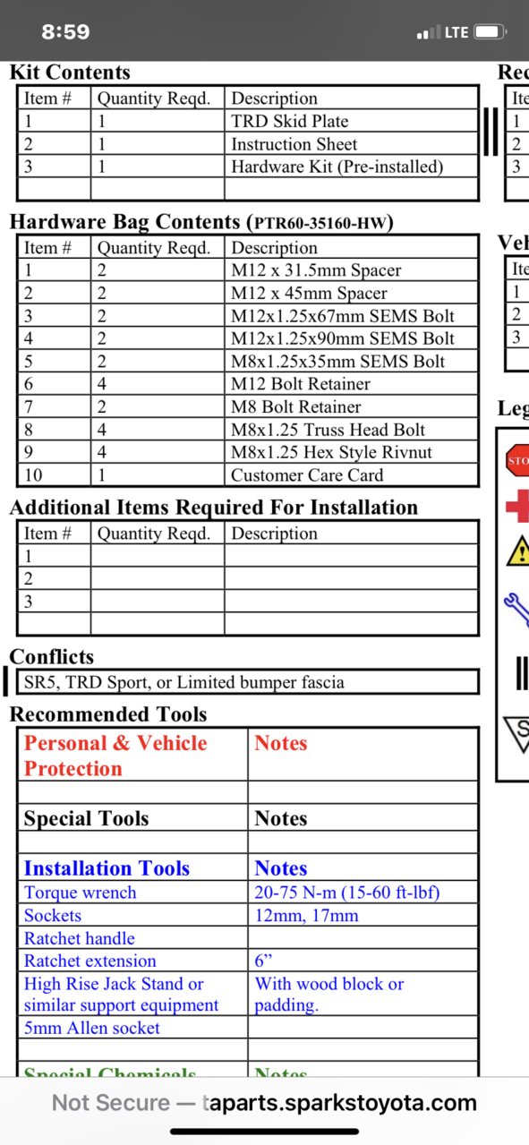

    They're M12.
    Use socket head cap screws for extra rock crawler points (uses same size Allen key as diff plugs)
