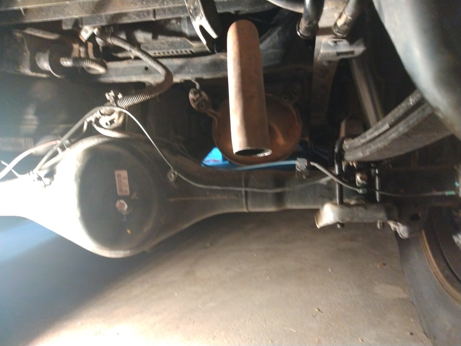

    You can tweak a stock exhaust or use a trd exhaust and cut it by the spare tire right after it turns down. If you’re slamming on rocks or debris that comes up past the frame rails you need to do more than raise the exhaust.

    Quiet, I'd buy an OEM off a junk truck and cut the tip off.

    It does. Vibrant 1141 I believe is known as good for that. That's what I got added to OEM TRD catback exhaust (2nd gen). And cut the tip off, paying attention to not cut it too short or anything.
    Still wanted to retain:
    -not directing heat at leafpack bushings
    -not directing heat at spare tire
    -still directing heat somewhat down and away, to avoid it going to the cabin or window
    TRD catback had highway drone that went away after putting the Vibrant which was designed to resolve that.

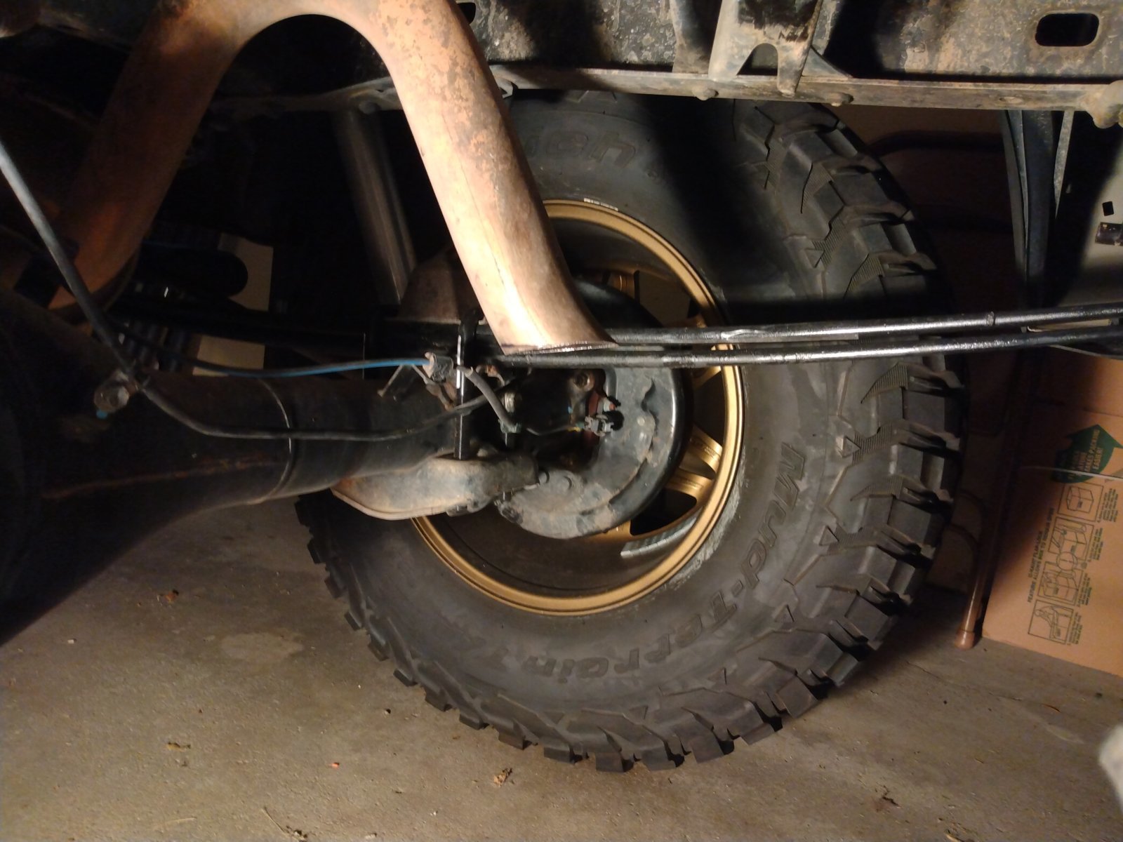

    I was worried about some strange harmonics, or extra noise when cutting the OEM exhaust, as I had a stock Off-road exhaust with a TRD tip.
    I ended up just going for it and cutting the exhaust off above the leafs.
    Zero extra noise, and zero harmonics.
    Worked a treat, and no cost to me, and clears all the suspension nicely.

    If you are trying limit damage to your exhaust, there are many threads about exhaust reroutes to eliminate the part of the exhaust that hangs below the frame cross member under the tranny/diff. There are also many threads about chopping the exhaust after the rear axle to avoid the tail pipe from being crushed.
    Neither mod has any effect on acoustics that I know of.
    My personal experience is that I have left my exhaust stock and it has not been damaged nor gotten me hung up. YMNV.
