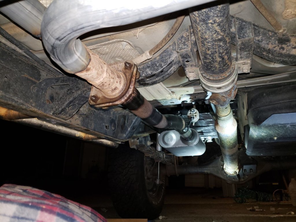

    Hey guys, I'm trying to find the QUIETEST low-profile (4" thick) muffler for my truck. I've searched the forum but am still seeking suggestions if anyone has comparative experience with these options in a stock exhaust configuration with a stock v6.
    I currently have a Flowmaster 40 Delta, which was chosen by a prior owner. I actually installed the current one, after the last one rusted, without giving it much thought. It's not overtly obnoxious, but over the years I've come to wish it were quieter. I do a lot of back-country exploring, and needlessly loud exhaust disturbs the tranquility. The worst is actually engine-braking, which is like half the time in 4lo terrain. Way louder than it ought to be.
    The problem is, I can no longer fit an OEM style muffler under the truck. I need something that is 4" thick. Here's a (not very good) photo of the current muffler, for reference ... the reason I can't swap in a stock muffler is because there's a big water tank right above it:
    Anyway, I'm considering the following, and seeking other suggestions:
    - Flowmaster 50 Delta, 17"L triple chamber
    - Borla ProXS (40665, 19"L) straight-thru with acoustic packing ... not sure of material.
    - Magnaflow 11256 (18"L), similar to Borla, but packing is stainless mesh
    - Hush Thrush, turbo-style, only 14"L, and a bit too thick, but apparently designed to be quieter?
    Engine is stock, with stock cats and pipes. Imagine you are peacefully camped out in the back country, and I am lumbering by at 2AM in search of my own spot. You can't fix my poor time management skills, but you can pick which muffler I have. What's your choice?

    If you want quieter, can you fit a longer muffler in there so there is more sound deadening in can? Meaning a muffler that is 20"+ in length but 4" thick?

    Thanks, I'll check those out. Agreed that longer would be quieter for any given type, I think the above listed are the longest available for each brand but ill widen the search to other brands. The current one is 13" and from my photos it looks like I could go to 20", or even longer if I start from scratch at the flange.
