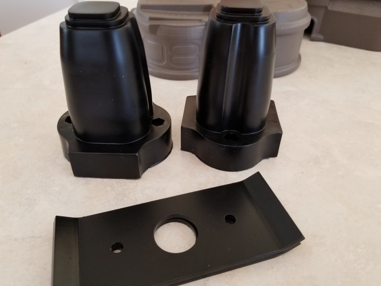

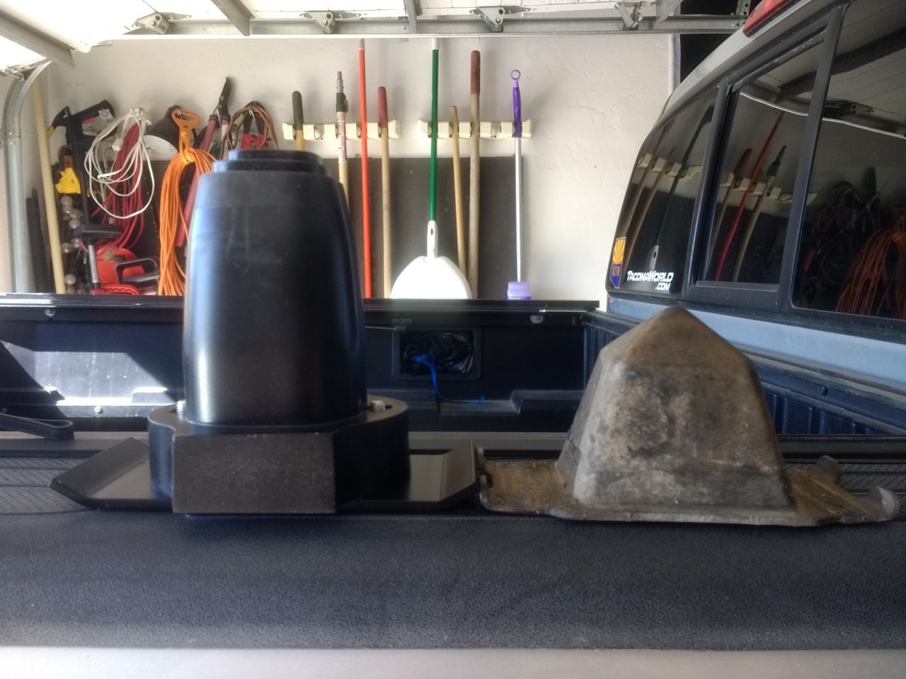

    Ok so we got to do do some serious testing yesterday. I picked up the rear bumpstop's from Curtis and they had just come out of the die . They are beautiful to me . Here is a comparison picture next to stock .IMG_20180907_152458543.jpg
    The stock stop is rock hard . Rock hard is good but not in a bump stop.

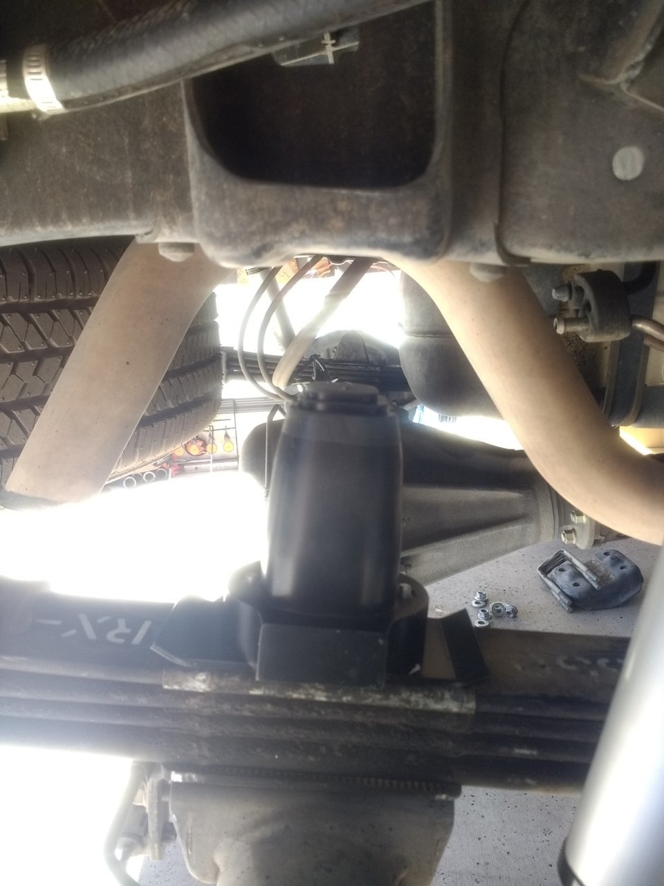

    Installation is a snap. Jack the truck up, pull the tire off unbolt the four ubolt spring seat assembly
    Remove the stock bompstop and replace it with the toyotabumpstops rear bump stop. IMG_20180907_153756659.jpg
    Bolt the ubolts back on 37foot pounds of torque and check after 100 miles .
    Now don't get upset at me but if you don't know enough to chalk the wheels and put a jack stand under the rear axle while doing this you shouldn't be doing it .

    That particular bump stop is 4.25" tall and compresses to about 3.5" under hard hits. it is intended to be used with truck that have a 2"+ rear lift and can accommodate a shock length of +1"
    I also have a 3.5" bump stop for stock height truck or mild lifts that will compress to about 2.5" under hard hits.

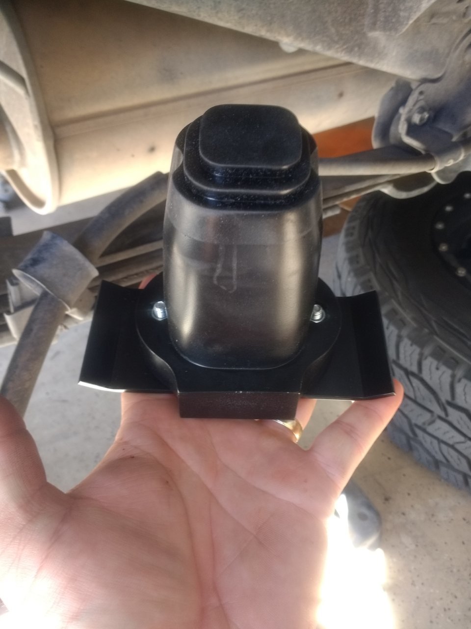

    There are two ways to mount my bump stops to your existing flip plate.
    1. weld the provided bump stop mounting plate to your flip plate.
    2. drill 2 holes and bolt bump stop to your flip plate. No threading needed.

    Any plans to to build one with a female threaded opening under it?

    No, that would interfere with the leaf spring center pin on most trucks. That is why there is a center hole on the flip plates, To allow clearance for the center pin.
