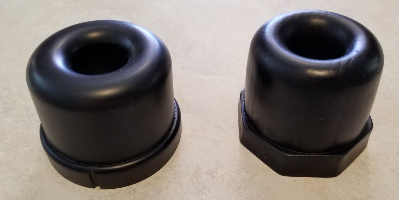

    Hi guys,
    Sorry its been to long! I ended up making a V2 that is stronger and looks a little better.
    My V1 was working very well. Guys are able to increase their speed significantly on the trail because the truck felt so much more planted without the hard contact of the bump stops.
    Well, this in-turn led to much higher speeds and compression than I had initially designed the bump stops for and I had two guys break a set after several hard miles of 55mph+ on badly rutted roads with large whoops. Basically the shocks overheated after so much abuse and without the dampening action from the shocks my bump stop was taking all the load and ended up splitting the base of V1.
    So! I made a V2 for the added abuse.
    Here is a pic of my V1 (hex base) net to my V2 (round base)

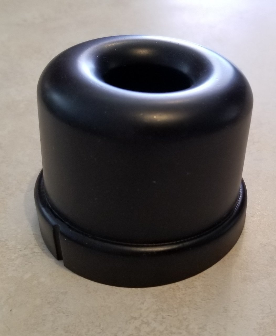

    This is a closer pic of V2. the notch in the casting should be facing the wheel during installation.

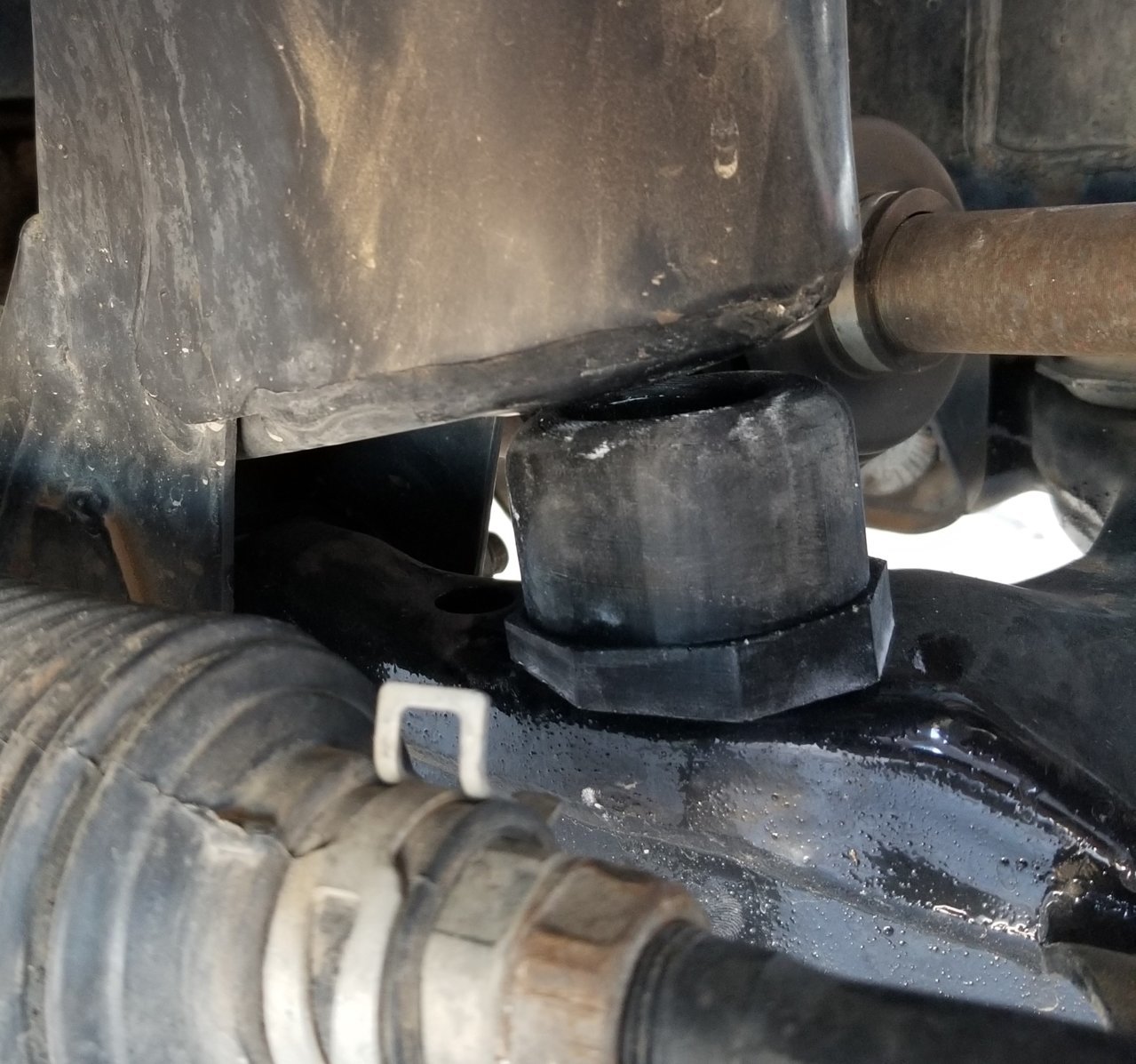

    This picture shows the fit of the bump stop with the truck on the ground. I still have about 1-1/2" of clearance before my bump stops make contact. This allows for our shocks dampening to be uninhibited by the bump stop until the nitty-gritty end of the upstroke.
    With the coil-over/shock pulled out and the full static weight of the truck compressing the front OEM bump stop. You can see how far the front OEM bump stop can compress and how my bump stop looks compressed.

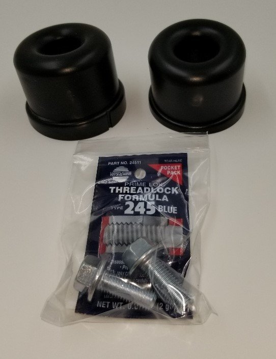

    Do you have a pic showing how it mounts to the 1st gen LCA?

    I supply the mounting hardware and a cute little blue thread lock packet. Its a 10.9 12mm hex bolt that goes through the center of my bump stop. Each bump stop has a cast in place washer
