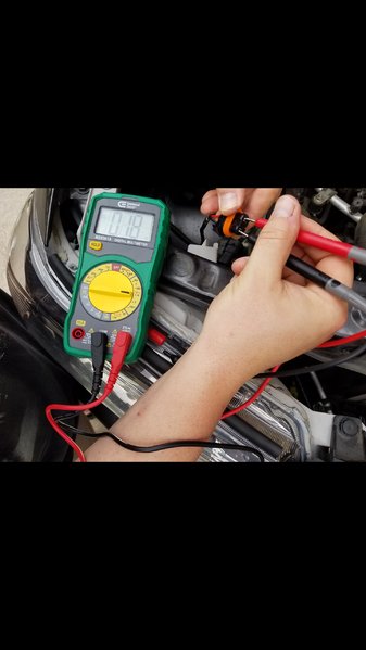

    I have checked that on both sides and still nothing. In fact I believe you are the person who walked me through a lot of the troubleshooting lol. I am getting the voltage at my factory plug when I engage highs, but it's like the high beam solenoids inside both projectors are dead.

    One more thing, check the high beam wire on your motocontrol harness. You are getting voltage to your oem harness, but what about the motocontrol one?

    The one your high beam wire is connected to high beam. Should be labeled as "high beam" on the wire harness

    I'll check it out later today. Is it the one that plugs into the plug coming out of the side of the headlight that Rechelon added? One red wire and on black wire coming out of the headlight and has epoxy around it to seal the headlight?

    It'll have 9006 female connector that plugs into your 9006 male connector coming out of your projector
    I believe this is what you are asking about. It is coming from the morimoto harness. It should .18V on low beams and then 11.61V when I turn on highs, but yet the headlight does nothing with them plugged in in either orientation.
