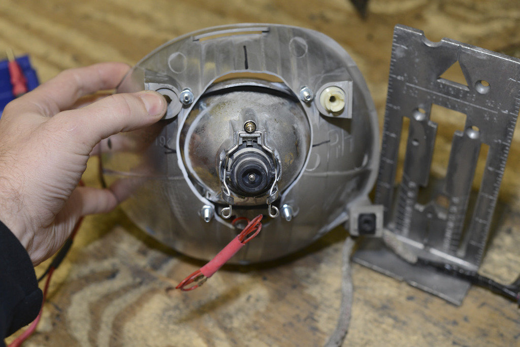

    Absolutely because you have the shaft and nut to mount to and it pretty much guides the projector center of where the originsl bulb is. FXR, Murano, And TL does not. So that means youll have to make markings to where the original bulb sits. Here is what i mean. See the cross hairs? Where they cross is where the original bulb was.
    If you don't align this like so, you can mount the projector too high, too low, too far to the left, or too far to the right. If that happens, you cant use your headlights adjusters to make changes if it's too far off. Don't worry, rechelon does align their projector as close as possible.

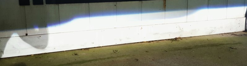

    Yeah, let's see your stock do that lol that is just the mini d2s. FXR is the big daddy of mini d2s. So yeah haha fxr is a huge improvement over stock. As bright as you can get without blinding anyone and it looks cool with your clean and sharp cutoff

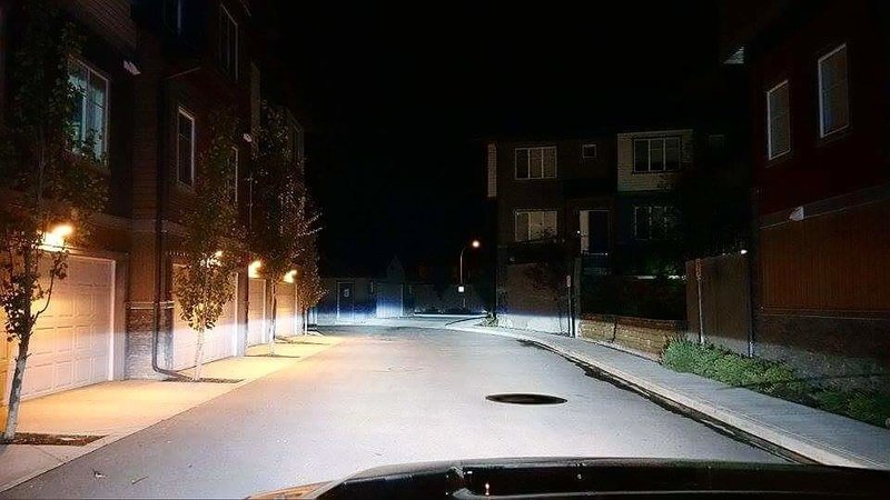

    As for j slopes, here is a picture with both projectors being muranos
    See how the left projector's cutoff kinda swoops like a J? A long J, kinda like a skateboard ramp lol
