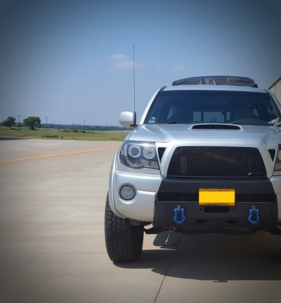

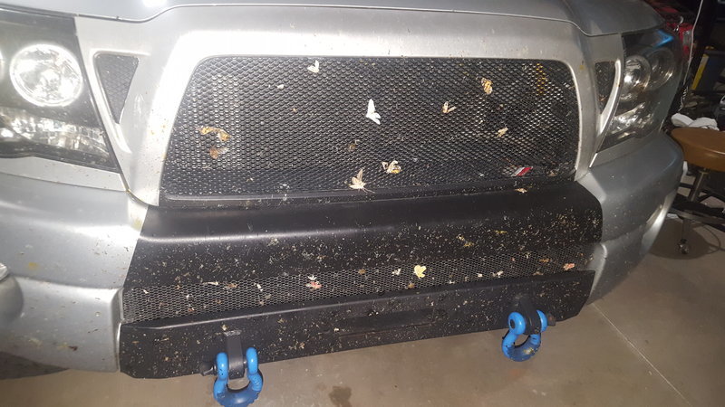

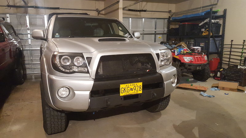

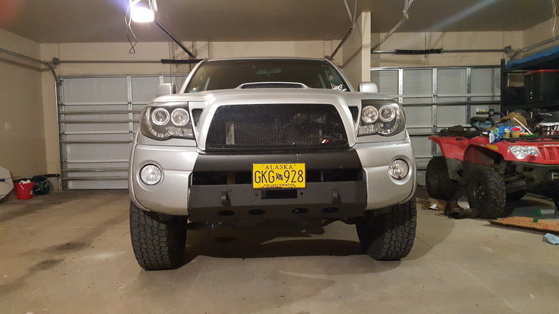

    New addition, US Offroad winch mount bumper. no winch in it yet, but i like the look, recovery options, and protection it gives. supper easy, bolted straight on.
    Before
    After
    Not sure if i'm going to leave all that black on the front or not...might peel off the plasti-dip on the center bumper and see how that looks? Any thoughts?

    need a new IFS skid. I like that this bumper covers even more than the TRD skid plate, so i don't need that now, but the stock IFS "skid" is really not much more than a splash guard...

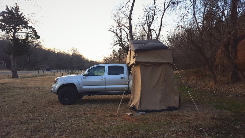

    Just a little camping in the winter here in OK by a local airport

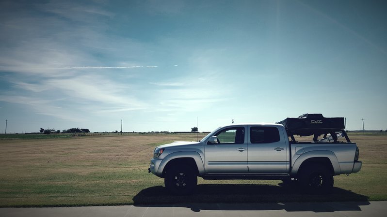

    I guess I never wrote this one up. I think I have other pictures better than this, but I added some canvas flaps for the sides of my bed rack to keep snow and some water off of my gear in the back. works pretty good for snow...rain, just ok.
    in hind sight I should have just used one large single piece of canvas and just bolted the tent on top of it. It would have made a better seal and honestly probably would have been less work. Maybe when I get a new rack or redo this one. (it's not very level...and really heavy) I think an aluminum tube rack would be awesome. save some weight and mpgs and avoid some rusting.
    That's with the flaps down.
    Flaps tied up with some 550 cord.

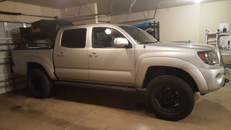

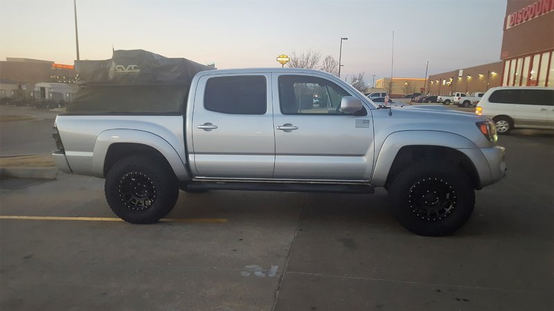

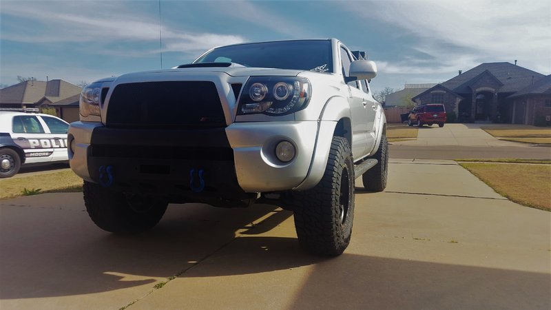

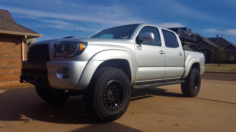

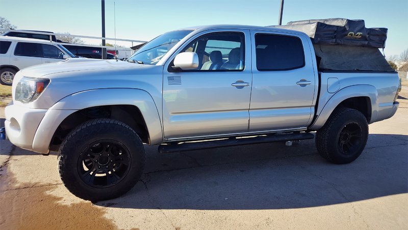

    Tires and Rims update! So I finally found some method NVs on sale ($10 off on Amazon). So the wife let me pull the trigger. I was going to wait until my Nittos wore out to go up a size and get some Falken Wildpeak AT3W's, but when i got to Discount Tire, they found the temporary plug i put in one of my tires and refused to swap the tires...I didn't argue much and my wife is awesome, so I got an early upgrade.
    I was worried about MPGs when going to 285 tires, but I think I found a compromise. The Falken Wildpeak AT3W in 285/70/17 only weighs about 50lbs, and the Method NVs weigh 28 lbs (78ish lbs overall). The XD cranks weigh 36lbs, and nitto terra grapplers in 265/70/17 are about 41lbs (77lbs overall). Haven't had time to check mpgs, but hopefully it doesn't make a huge difference.
    Clearance and rubbing:
    Currently sitting on 5100's (with stock sport coils) set at 1.75" of lift.
    I was also worried about how much i would have to trim, but so far (for just regular driving) it's not much. Just a little bit off of the rear, inner corner of the fender flares. I'll have to do the pinch weld smash for offroading (maybe...probably... CMC) and we'll see how much of the fender flares, etc I'll have to chop when the suspension is cycled. Hopefully 175" of lift will be enough to keep from hitting the tires on the top of the fender well at full stuff. I haven't seen many people run a medium lift like this with 285s. Also had to use some zip ties to move the front splash guard up and out of he way, but i think that will work out nicely. I also found out Method NVs don't have the cavities cut out in the back for a less than 1" spacer...so I had to remove mine and I was worried about rubbing the UCA, but that doesn't seem to be a problem! yay!. on just the short drive home the noise didn't seem to be too bad, but i didn't get to highway speed or anything.
    Here's the before.
    And After (I'll take some better pictures with better light tomorrow hopefully)

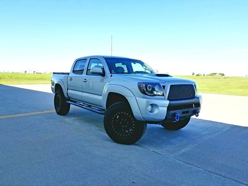

    Some better pics.
    Close up =D

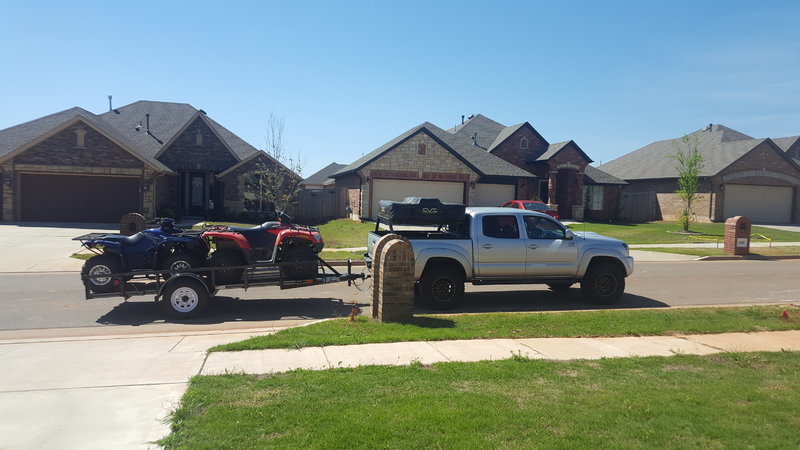

    Got a new trailer and a new ATV for the wifey. All loaded up and ready to go.
    getting ready to play

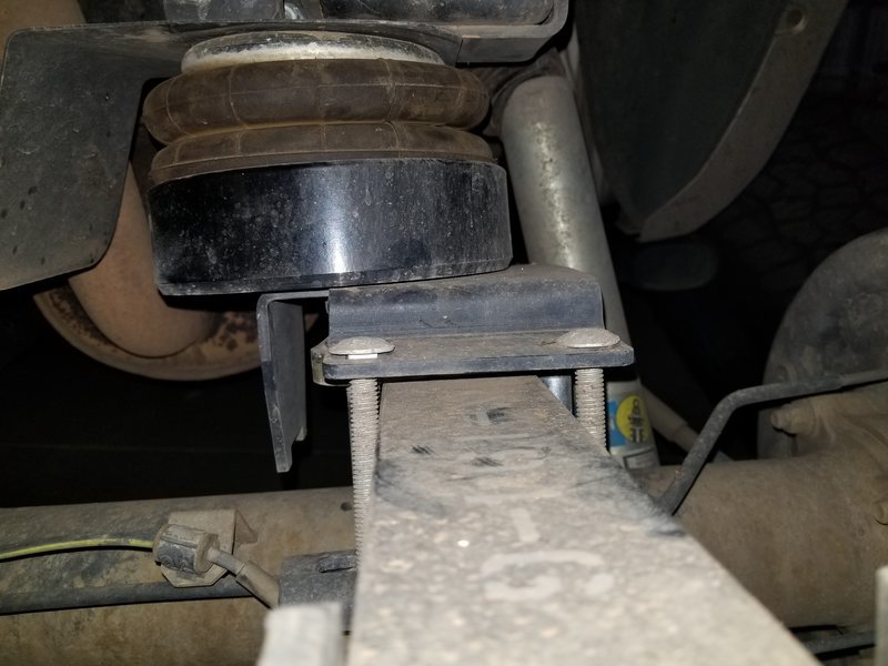

    Here's a picture of my air bags (deflated in this pic). Because of my ubolt flip, the bottom plate doesn't sit as low as it should. And after looking at some other builds, I should probably get some hydraulic bump stops and maybe that will take some of the jolt out of the harder bumps and potholes.

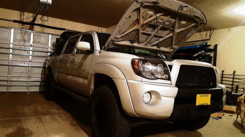

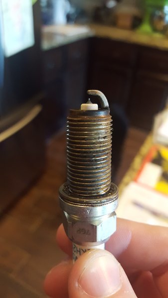

    And this is what happens when you forget to change your spark plugs at 30K and do it at 45K miles instead...not much left for sparking...the gap was sitting at max, which is good I suppose, but they are pretty eaten up, lol.

    How do you like the US offroad bumper. I've been looking at that ilo a full bumper.
  20. May 24, 2017 at 1:41 PM
    #80
    R09ster
    R09ster [OP] Well-Known Member
    Apr 6, 2013
    #101482
    625
    Josh
    OK
    06 SSM DCSB TRD Sport
    debadged, Bilstein 5100 all around (fronts at 1.75" sport coils), Skyjacker softride 1.5" AAL, Firestone Ride Right Airbags, 17X8.5 Method NVs, 285/70/r17 Falken Wildpeak AT3W, US Offroad hidden winch mount, grillcraft grill, Sypder Auto projector headlights, blackedout LED taillights, bed extender, bedrack w/CVT Mt Shasta tent,
    I like it a lot. Strong and gives you the recovery points, but it's only half the weight. It was nice and easy to install. It also wasn't as expensive as a full bumper. I'd love a Brute Force Fab front, but this was a bit more reasonable for what I do with the truck, lol. Then you don't have to completely redo your suspension.
