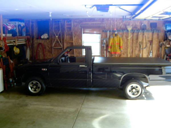

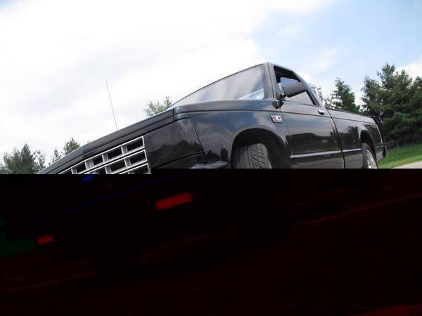

    I don't have any pictures of it completely stock (because it didn't stay that way very long) but this is what it looked like after i got it painted.
    Gloss black $500 through a work connection of my dad's. FREE clear coat! (the guy said it looked so nice, he couldn't help it...so he put it on there for free, lol).

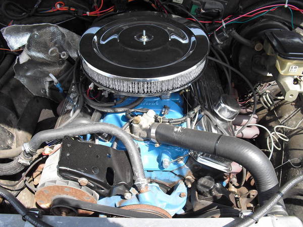

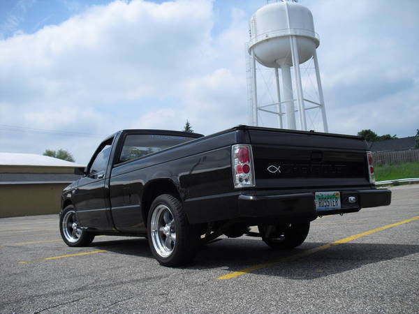

    after seeing that awesome paint job, i couldn't help but mod it from there. first some Euro tail lights, but the bit kicker was a high school graduation present to myself. a guy at work just happened to have a 1985 camaro 350 laying around...so i got it and the tranny for $700 with lik 3500 miles on it after being rebuilt. originally carb'd, we switched it to EFI for a while, and then said screw it and went back, mostly because it was way easier...
    dropped that in there with a conversion kit from LMC. there's not much room in there....
    (you can almost see that the steering shaft goes through the middle two headers on the driver's side, lol)
    had to get a hi output, low profile electric pusher fan for the radiator and a new, higher performance, low profile radiator (for space). and removed the mechanical fan for obvious reasons. new water pump, valve springs and bushings. had to apply some good elbow grease/sledge hammer to the firewall. also had to get a B&M floor shifter because the column shifter hit the engine block...couldn't shift into drive. (looks way cooler not anyway and the ratchet shift is a blast)
