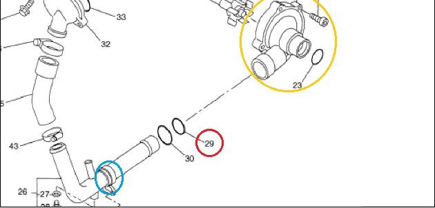

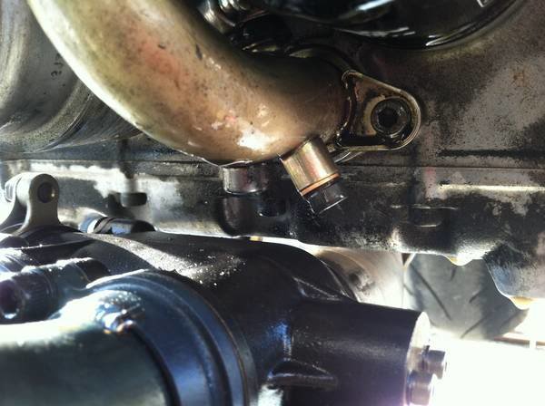

    What you are looking at in the above picture is an elbow that goes into the bottom of the crankcase of the bike, it is a part of the oil cooling system. We were in a situation which required us to remove this elbow. See diagram below now.
    The part that has the blue circle is the above pictured elbow, the blue circle is where it goes into the crankcase, so that is where the crankcase wall is. The elbow goes into the yellow circled thingamajig(waterpump?) which as you can see has two o-rings, that is all inside the crankcase. When we pulled the elbow, we might have pulled out the 2nd red circled o-ring off since only the 1st one was on there(The coolant was flushed prior and there was no oil in the crankcase when we pulled the elbow), we reasembled the elbow thinking that the 2nd o-ring must be in the yellow circled part, long story short the oil became milky after running it a couple minutes, we think that the 2nd 0-ring fell off and now there is water entering the crankcase.

    I could be wrong but the picture is not the same piece that is shown on the blown up drawing. The picture is of an oil pipe of some kind and the drawing is of the water impeller and the water pump housing/piping. You could have blown the seal from the impeller shaft into the crank case for how the impeller is driven.

    The picture and diagram are of the same thing I'm sure of it, its not an oil line, thats a coolant line that runs to the water pump, which I am pretty sure is in the crankcase. The bike is a 2003 R1
    The reason that we had to remove it is because we snapped the coolant drain bolt while tighting it(which is the black bolt in the 1st pic). We removed it and tapped the bolt with a drill to get it out. All of this mess over one snapped bolt.
