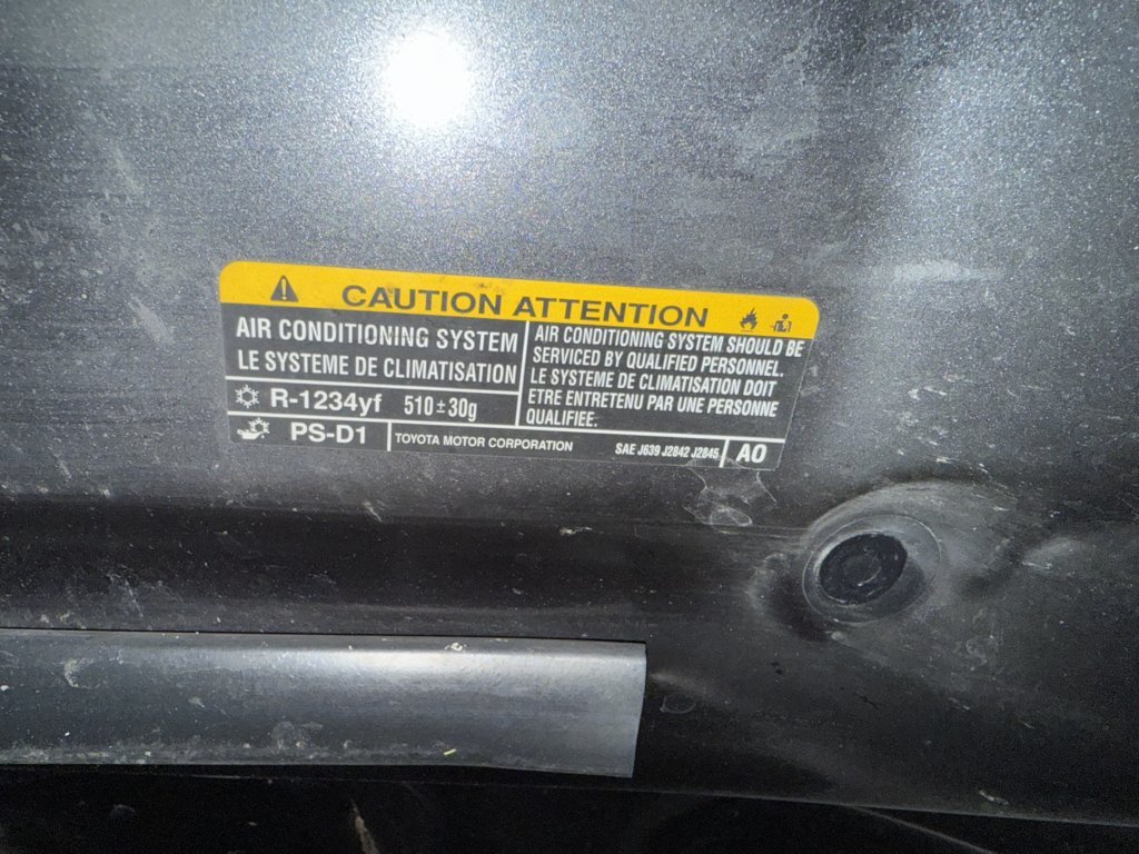

    There's a sticker under the hood listing refrigerant type, oil type and charge amounts

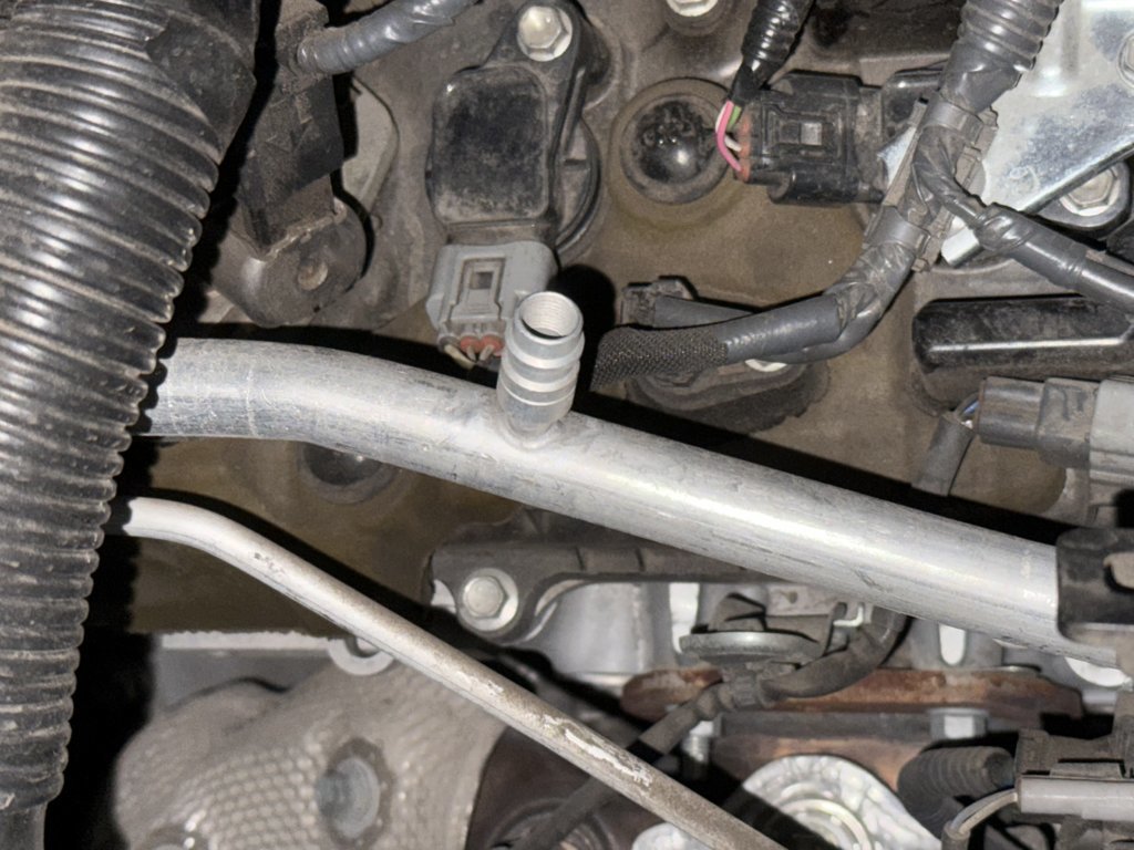

    Well, I don't know what happened to the sticker under the hood. This is the low pressure fitting on the passenger side,

    What about the high side fitting? YF high side fitting is bigger than normal

    I check tomorrow. If I can find it I'll take a picture and post.

    I can't find the high pressure fitting. :rofl:I did find this though,
    Truck was built in Mexico December 2016 and sold as a 2017 model. I guess that sums it up.

    High side fitting is in the radiator support behind the grille...right side.
