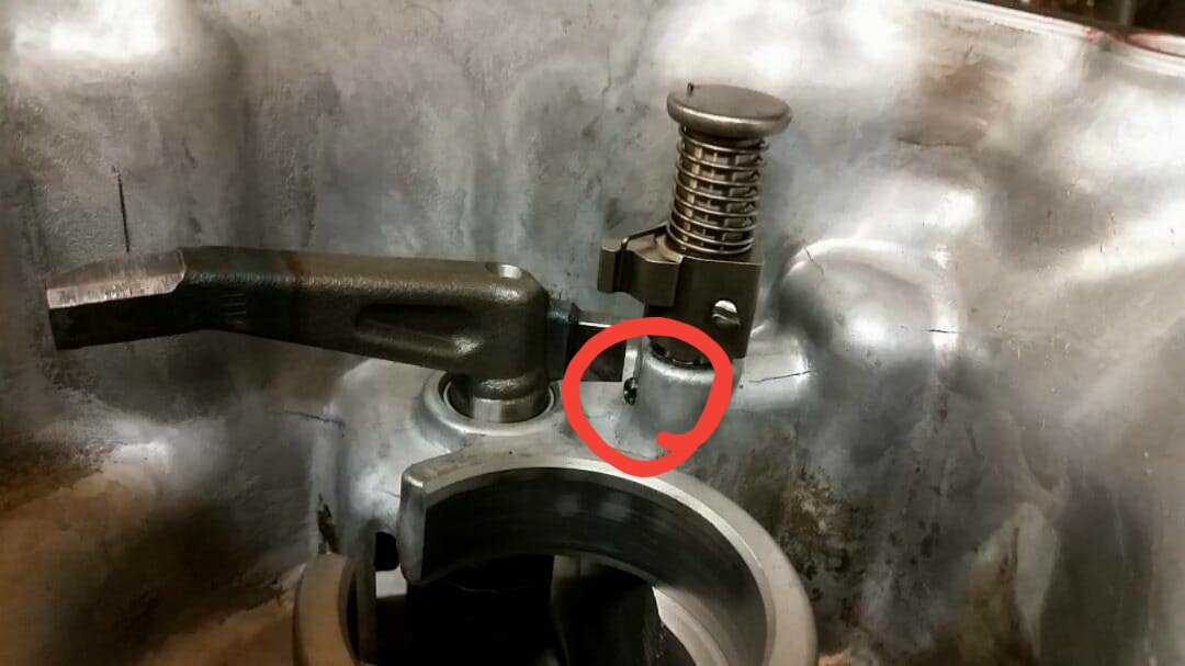

    That is too bad about the delays. I almost went the Marlin route for my R150F but I rebuilt it myself instead. I didn't like the long lead time but it probably would have still been quicker than my procrastination! I took mine apart in May and finally got around to assembling it and installing it mid-November. I wanted to do a good job so I bought two books on Amazon that helped along with the factory service manual. I have about $300 bucks into it using all OEM Toyota bearings. The blocking rings were in good shape still so I didn't replace them.

    I tried rebuilding mine. However 5th gear does not want to quite lock in. Almost like a need another 1/8" of travel to fully lock it into place.

    Did you get it installed and realized this or bench testing you realized this?

    If the circled roll pin isn't pushed in almost completely flush it can hinder the shift lever travel into 5th gear.

    No on the bench everything seemed fine. But when driving and everything is turning and going is when it gives issues. Funny thing is when I first put it in after rebuild no issues. Drove it about 15 miles no issues. Then I drive it and start having issues. I wonder if the pin you are suggesting is the cause of my issues. I even bought a marlin short throw to eliminate shifter issues. I feel like it’s something really simple that I am missing. Just don’t know what.
