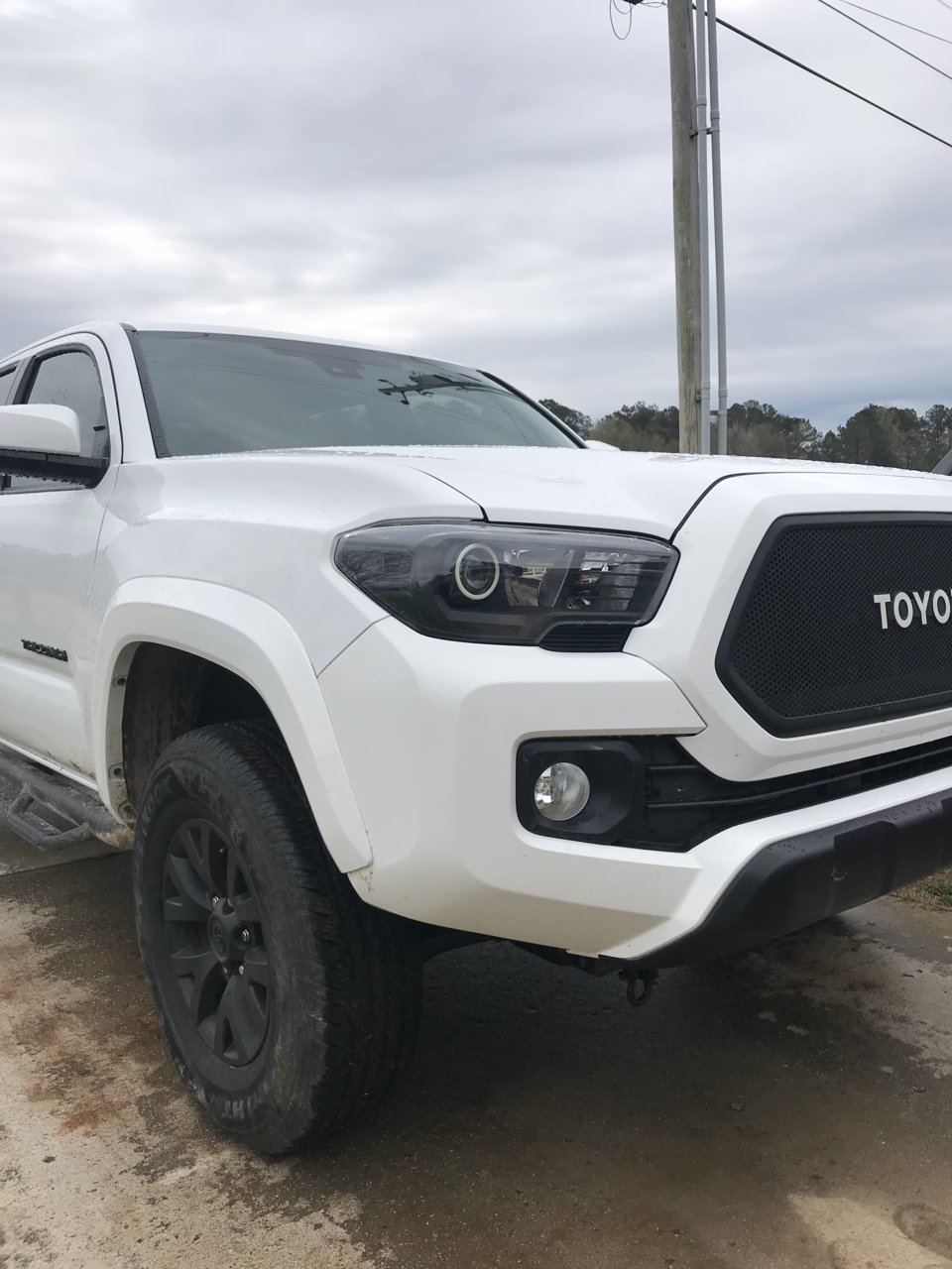

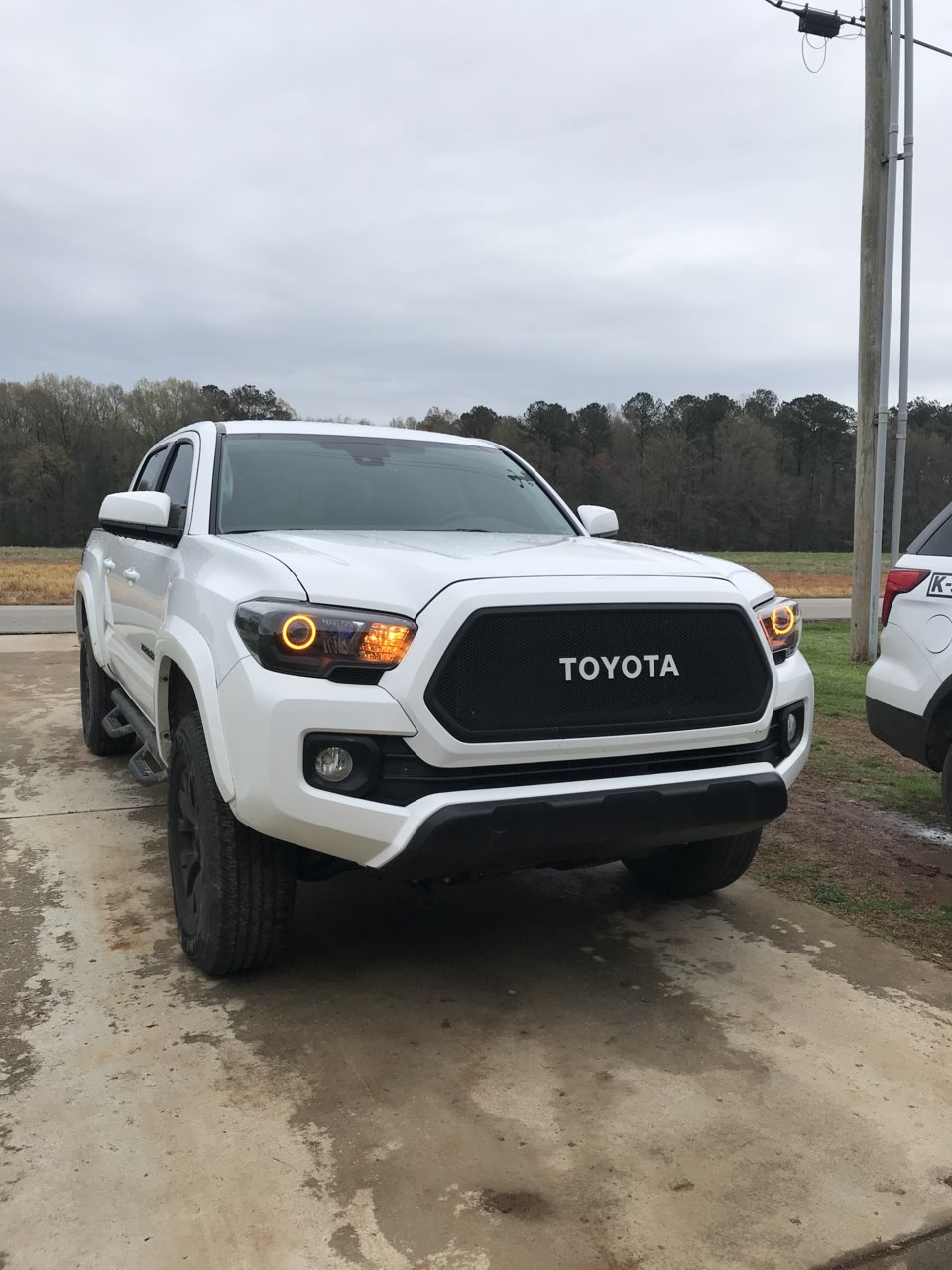

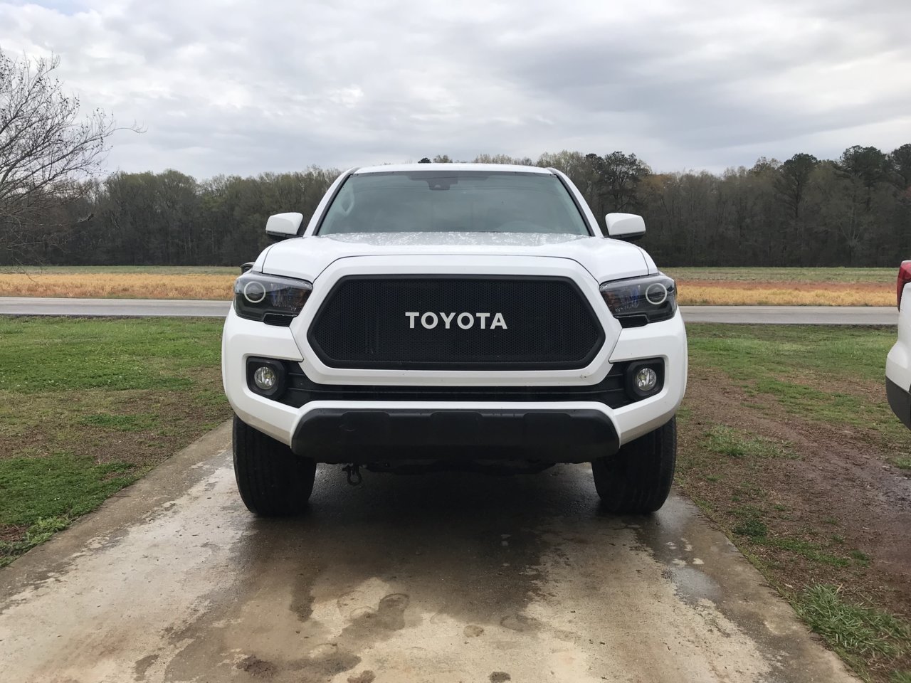

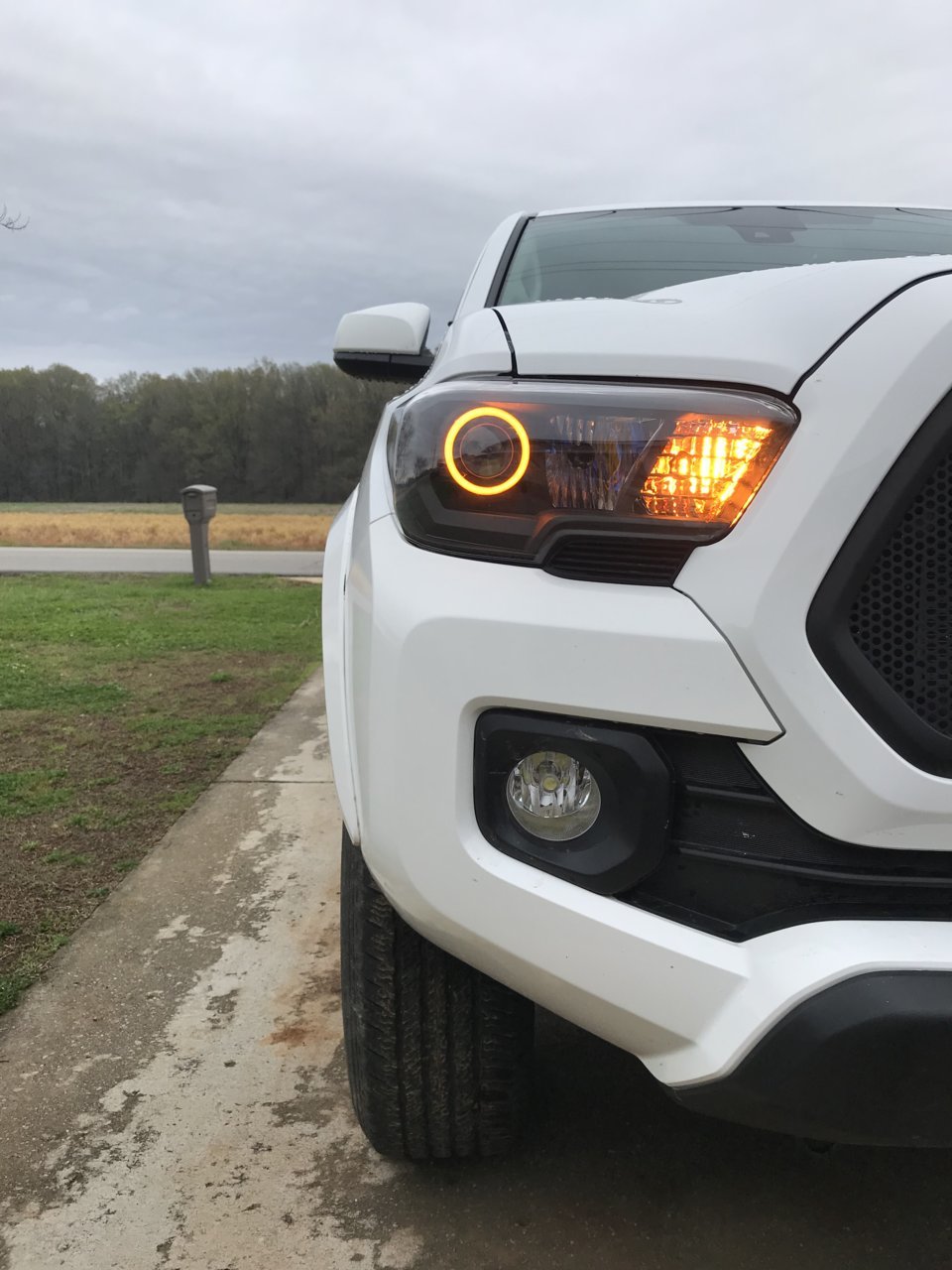

    66F936BB-7055-4A73-8244-AE96AD7C8C5C.jpg CD587959-3602-4D70-B539-786A4D034BB3.jpg BFF40C77-0862-4BF9-BC93-84A8CC2FF8F5.jpg 532CA003-58EE-44AC-91A0-E63CE7851EC0.jpg BB9B819A-0211-4C20-9D40-FEFC86050CEE.jpg It is finished...even though they are switch back capable I decided to leave the white halos out of the equation and just run the ambers 24/7. It just looked too good not to lol. Installation difficulty I’d give it a 6 out of 10. Hardest part was separating the housing and lens but after that it was easy. Definitely worth it in my book. Enough talk...MOAR pictures :eek:

    Did you just wire the LED halos up to the DRLs? Any additions to wiring to make that work?

    Sorry for the delay. Out of the xsb box there are 3 wires, white, amber, and black. Black is ground and the other 2 are the white halo and amber halo. Normally you would attach the white to your positive on the side marker and attach the Amber to your DRL lights so that when the turn signal is engaged they turn amber and flash with your turn signals/DRLs. All I did was not use the white wire and connected the Amber wire to my side marker. So now when I have the side marker lights on (the switch setting in between DRL’s and Headlights On) the Halos come on.

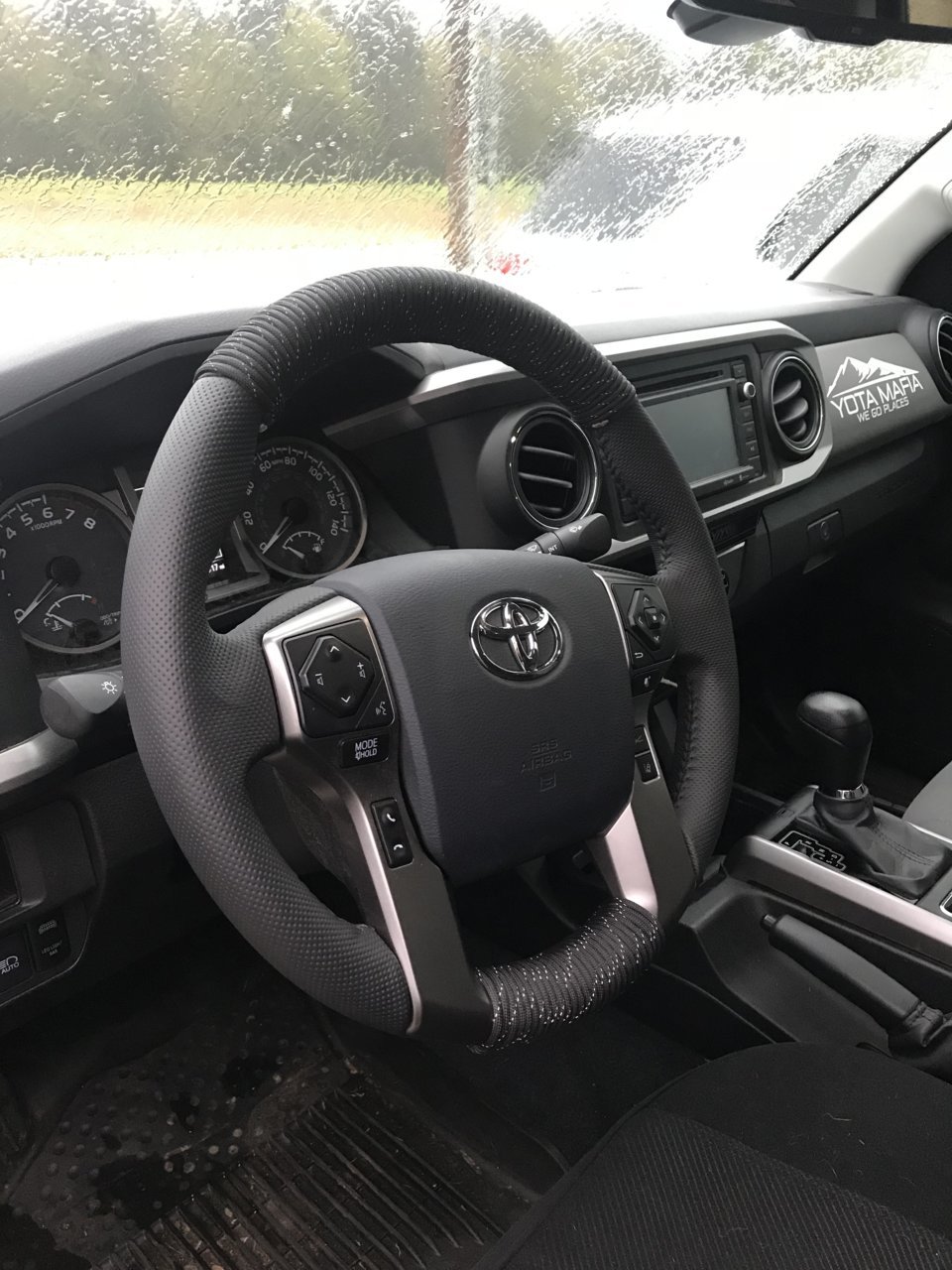

    21E3612D-EAD1-42C9-A645-06DE2F2B6D7D.jpg Also did a paracord wrap on my steering wheel with black cord with reflective stripes. Solid black may have looked better but this is what I had on hand lol
