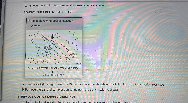

    I have the top drivers side detent spring out but I can’t get the detent out. I dropped the shifter back in just rocked the hell out wiggling the hell out of it. I’ll push it back out of the shop and take it for a quick spin and see if it will pop out. I did a little beat down drive around the yard last night up and down a little hill trying to load and unload it. I’ll go try the blacktop.

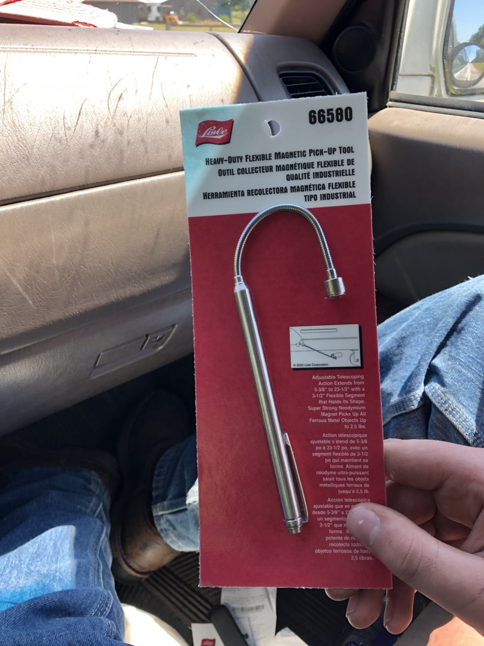

    No luck on the blacktop. Let the exhaust cool down and ran to town and got a flexible magnet on a stick. Hopefully this does the trick:fingerscrossed:891C5064-5ABC-4B73-B4AB-2C54B25C4D29.jpg

    Got my fingers crossed that flex magnet will get the detent out

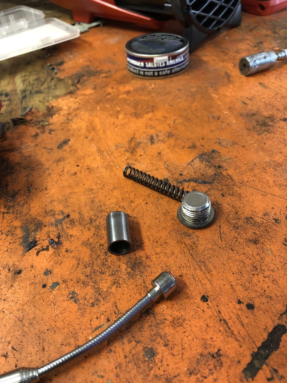

    EA8F191C-984A-4D4F-9D30-FD86E1BAADE6.jpg Snagged it out no problem. Still stuck in gear. :annoyed:

    I believe that spring moves the shifter to the neutral position
    There should be other detents on the side of the transmission case that you can remove . Usually an allen key removes them .
